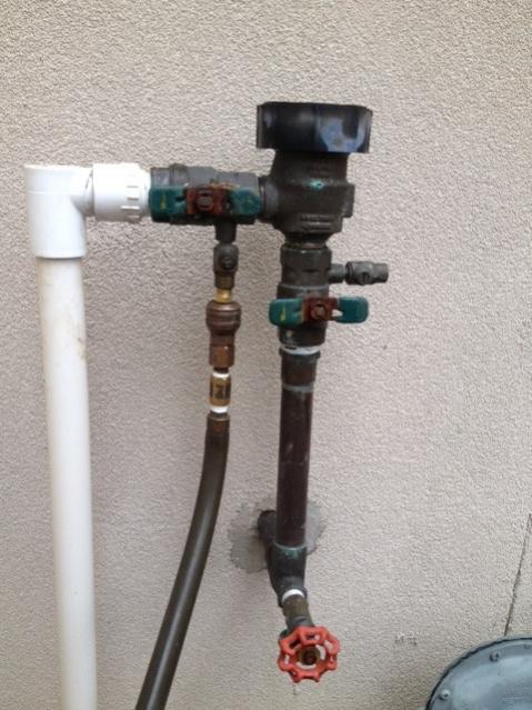

First year trying to DIY my winterizing.
Rain Sensor Off
Hooked up 20gal compressor to the valve
Pressurized the system at 60-80psi. Heard the air going strong
Turned on my Hunter Panel. Manual zone for 10 minutes. No movement.
I have a feeling i have the compressor hooked to the wrong inlet.
Any help appreciated. Thanks
