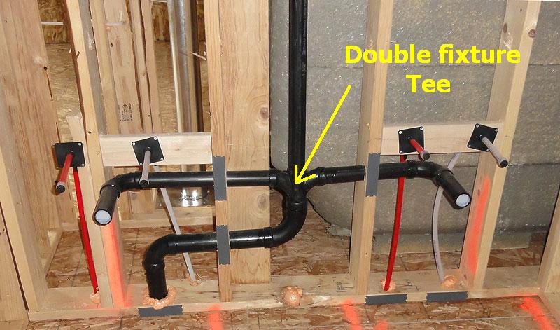

Why can't a double sanitary tee(DST) be used here instead of the double fixture tee(double fixture fitting)? Does it have to do with in case the line needs to be snaked? The snake most likely would have a tough time going down once it reached the DST?
What is a situation where a double sanitary tee can be used?

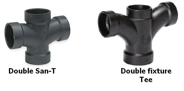

A double sanitary tee can be used for a vent fitting.
If you snake a double santee, the snake goes right across and toward the other p-trap.

A sanitary cross creates "crossover" of waste is "almost" impossible to snake through it. A double "combo" creates "3/4 S" traps, so the double fixture fitting is the only proper one. A "'double sanitary tee" is not necessarily a "sanitary cross". There are double sanitary tees with the two inlets one above the other and others with them a 90 degree apart.
