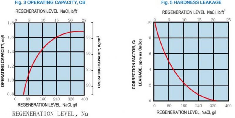

    Here is a great article on softness of the water. http://www.wcponline.com/pdf/1203Michaud.pdfName:  leakage.jpg
Size:  42.0 KB A softener regenerating with 3 pounds per cu. ft. will have some bleed, this is normal and well charted. A softener regenerated with 6-8 pounds will have much lower leakage, but you will give up some of the efficiency. 6-8 pounds is still very efficient. See the attached chart above for detailed hardness leakage / efficiencies. As you can see, you will near the 1/2 GPG mark at 3 pounds of salt, this does not take into consideration end of run (the day or two prior to regeneration where leakage will be much higher).

    I think it says here http://www.wcponline.com/pdf/0202brine.pdf to expect 9 to 10 ppm hardness leakage with a 3# salt dose, slightly more than 1/2 grain, not all that bad. They mention the Double Backwash advantage here: http://www.pentairwatertreatment.com...er%2042755.pdf
    I might bump up the salt dose a bit to about 4lbs...

    That is a great old article. It has a few minor items that some people would disagree with, but the article was written with generaliztions, not absolutes. So the arguments people have made to the article are usually based on unusual application methods, not on the 95% of common applications. The only way to avoid these people who are always looking to argue, but refuse to write articles themselves would be to write a book on the subject with every possible scenario... not really an article anymore.
    Try 4 pounds of salt, but remember that you wont get the actual hardness leakage for several regenerations, and the leakage increases when the system nears regeneration. If you are happy with the water at 4 pounds, then keep it there. If you want it a bit softer, bump it up to 6 pounds, you will lose very little efficiency.

    I take it that I should I also up the capacity, like to 20K if I decide to use 6 pounds? Or 15K with 4 pounds?
  9. #24
    Jan 2012
    1,083
    Correct, the capacity is based on the salt usage. As you can see, the efficiency goes down, but the quality goes up with higher brining levels. Up to 6-8 pounds is the most popular to balance the efficiency and quality.

    Dittohead,
    I understand the leakage vs amount of salt used for regeneration. But I have the SST60 resin that leakage should be about 4 times less than you state!
    link; http://www.caitechnologies.com/image...pecs/SST60.pdf : see figure 6 and the chart below.
    It seems to me that you are taking a very conservative stance on this (more about this in a new thread soon).

    The SST60 resin is approximately double the cost of a high grade 10% crosslink resin. The lower leakage is beneficial for some commercial applications, but there is still a lot more to the story. Too much to go into here. If you can afford it, then it is a good resin. Will it pay for itself in salt savings? Not likely, sot of like a hybrid car. The ROI is so far out that it is difficult to justify. We only have a few customers that use it, we sell thousands of cubic feet of standard resin to the few feet of SST.
