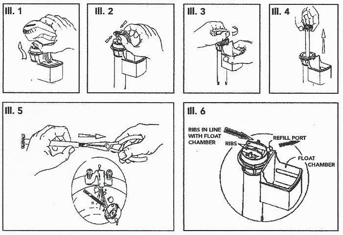

    Hey checked,
    It's a fill valve issue. I just ordered one, can you show me to a video? Thanks.
    19,232
    You don't normally need to replace the whole valve...the cap is the easy thing that makes the seal. There could be some sand or other debris caught in there, and just taking it out, cleaning it off, and reinstalling it may solve the problem. The instructions on how to replace the cap are on the package - it's a couple of minute affair, and no tools are required. If you really want to replace the whole valve, that's a little more involved, but still easy.

    Quote Originally Posted by bkim84 View Post
    Hey checked,
    Here ya go... Let us know how you make out.
