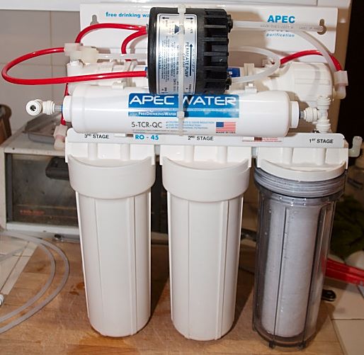

Rebuilt and ready to go
I finally got the last few fittings to rebuild the RO with permeate pump and new ASOV. It came with the ERP-500 pump, so I installed the auto shutoff valve also.
It pumps water. Whew!
I will say the schematic of the permeate-pumped upgrade is complicated, and the valve port function differs from the picture in the schematic, so one could easily make an error. Cross referencing the valve to the schematic was required. Additionally, it was more convenient to install the flow restrictor on the outlet of the brine side of the pump instead of the inlet.
A faint whine is heard occasionally, with the trickle of water into the waste pipe being the loudest sound. I am glad for the recommendation to insist on the quiet pump, as the original vendor of my RO45 (45 GPD) filter only sold the ERP-1000 pump. I have no need for the added water production capacity, or noise. I bled the tank and recharged it to 7 psi. I think it had been near zero. The filter canisters were all stained and had a slight iron and carbon film from 6 years of operation fed by 40 year old unsoftened scaled iron pipe, regular filter changes notwithstanding. They're clean now, and get feedwater from carbon filtered, softened copper pipes. That pre-filter used to be orange 9 months out of the year. Bet it stays clear now!
Incoming TDS was 450, after the RO it was 49. This was water produced directly, not stored in the tank. I wanted to purge the system and not let it go into the tank. So after the lines were clear I let it fill the tank. TDS is now up to 100 when drawn from the tank, with a few air bubbles. I guess it is too soon to be testing TDS, I'll have to run through a few tanks first. The tank is old, but hasn't been operated in a totally failed system.

After running one tankful through the filters TDS is now down to 10 PPM, which works out to 98% rejection of the 450 PPM supply water. Tastes better too.
