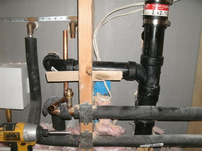

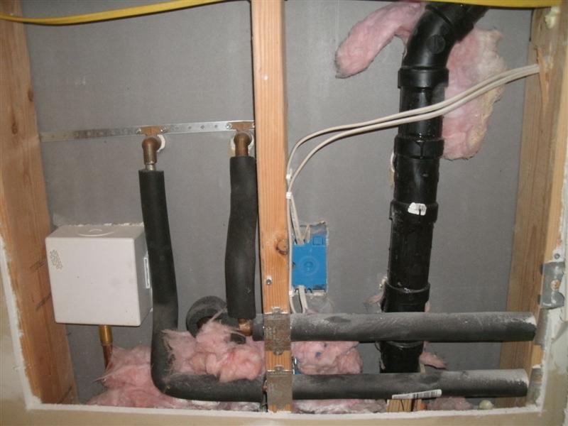

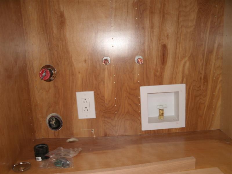

    Long story short, we re arranged kitchen cabs, and bought a deep undermount sink. My stub out ended up here:Name:  kitchen counter sink 008 (Medium).jpg

    So I cut out the 2x1 1/2" SAN T , lowered another one 3", and ran it Horizontally 8" or so, and installed a 1 1/2" sweep to stub it out in a better place between the bowls.

    So my question is, is this really kosher? Or do I need to move the whole island set up over?
    23,562
    It is the way we do it at least 50% of the time.

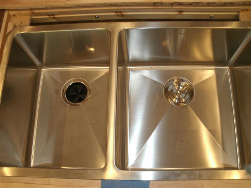

    Is there a way to legally install like a combi wye on the stub out to use a trap for each bowl? I don't think I care for the directional center t deal.

    I think I figured it out. If I add a san t above this one, and stack another one on top to the other side, it's low enough to hit the basket. The disposal was the issue being lower. Thanks again. J

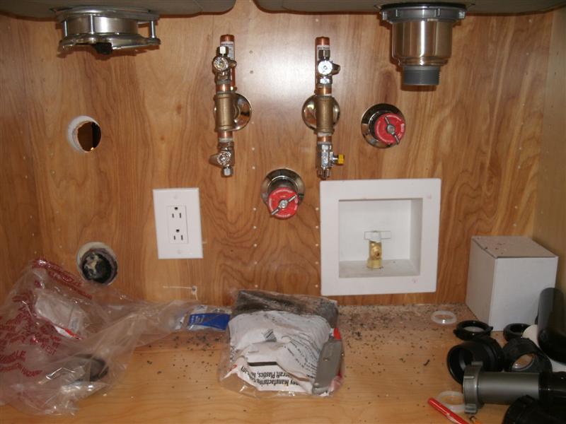

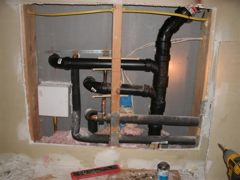

    Finished product. I like the idea of seperate p-traps for the disposal and sink.Name:  kitchen counter sink 014 (Medium).jpg

    Jan 2008
    2,681
    That would fail inspection in some areas as you now have a wet vent on the lower trap.

    With what you see here, is there a way to re-arrange the fittings and vents in this space to comply with UPC code?
    12,448
    UPC would be happy with a fixture cross, or to stub out once and use a disposer kit with one p-trap.
    A fixture cross puts the trap arms at the same level as the vent, which makes it correct.
    Or stub once, and connect under the sink.
