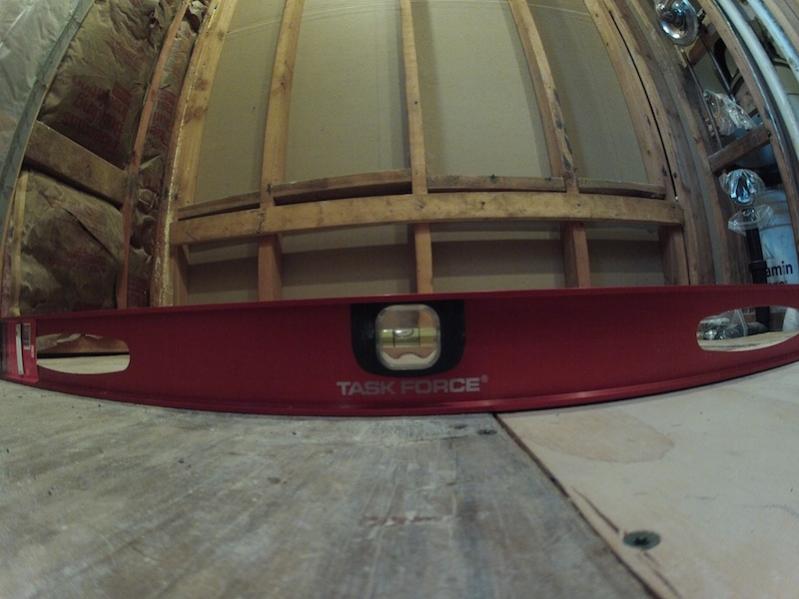

    The floor is ever so slightly out of level. I assume this isn't anything to worry about and even shimming isn't needed. It must be less that 1/8" out over 4' and it's out in the "right" direction. If I put a piece of shingle under the end of the level, the bubble is "off" in the opposite direction.
    21,401
    YOu may want to install blocking for a future (or now) safety grab bar(s). You never know when one is needed. I will say that I just put in one for my mother a few days ago and used WingIts. Really slick, and you specifically don't use them in a stud. But, it's cheaper by far to just screw it into blocking.
    You want the tub to be level, so may need a metal shim to make it so - it needs to be level L-R and F-R.
    You need to make sure you leave enough space around the 3" pipe to glue the new flange on. You do want a flange with a metal ring and it should be on top of the finished floor. Keep in mind that some flanges won't slide down flush, and some will. You need to check how square the top of the flange is both on the inside and outside so it will fit into a narrow slot.
    14,201
    Your out of level floor is another reason we use a ledger at the back to support the tub.
    The ledger should be installed with a level, and then the front apron gets shimmed to prevent rocking.
    For the closet flange, I would pick up a spacer and set that under the closet flange, and then tile around that.
