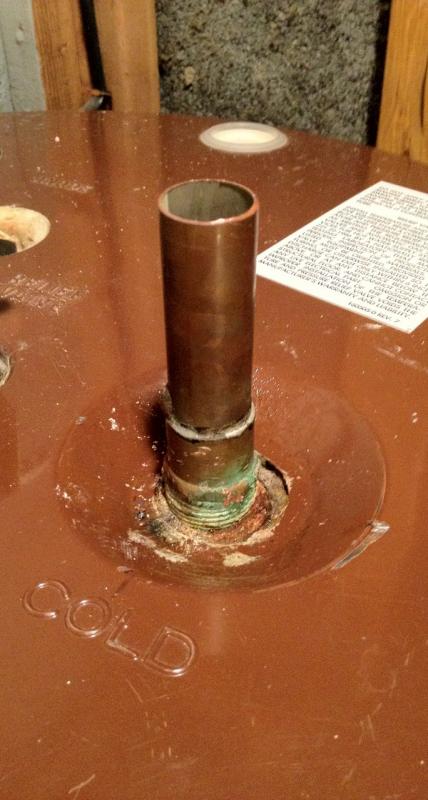

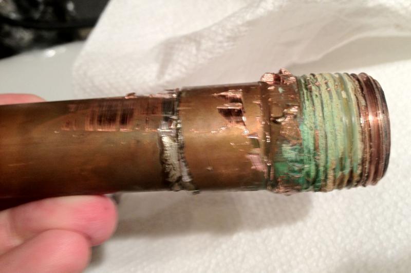

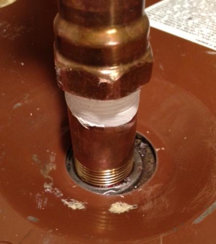

    I just installed a hot water expansion tank, as my first ever "real" plumbing job, put everything back together, and ended up with a bit of seepage after restoring pressure to the system. (I learned how to solder copper pipe from YouTube and from some of your posts, and that part is fine.) I also flushed the water heater a few months ago, and replaced an ugly anode rod with a new magnesium rod. The water heater had a bunch of sediment, but no sign of rust to my untrained eye. But that's mostly beside the point. Incidentally, this is a 66 gallon AO Smith EES 913, possibly dating back to 93, judging by the serial number.
    My main problem seems to be with the threaded female inlet to the tank. It looked ugly to start with, but it wasn't leaking.

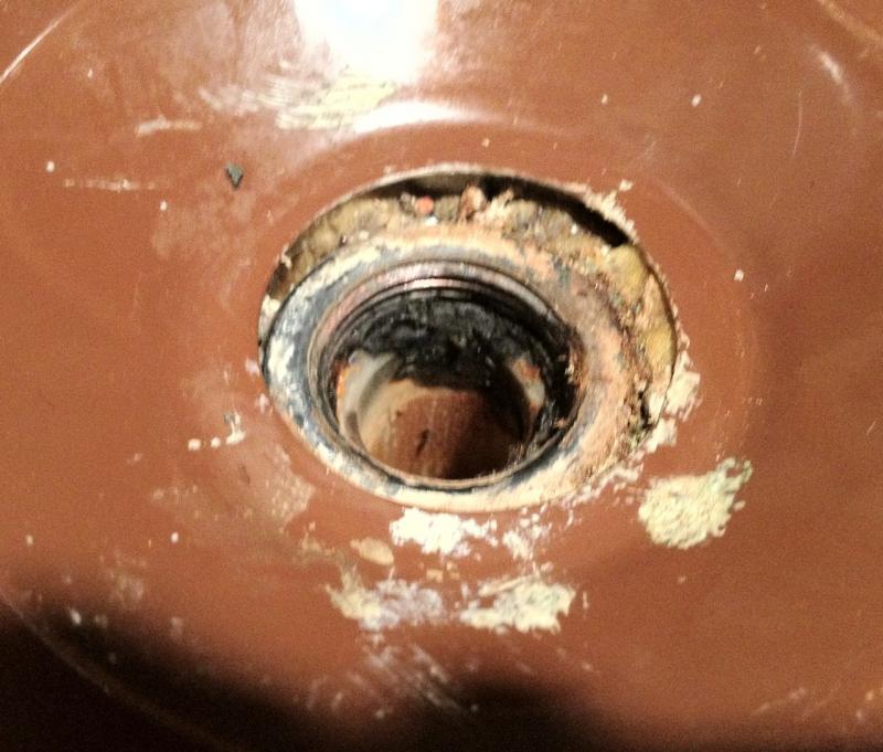

    After understanding what I was looking at (I think), I found myself a little dismayed at how few threads were there and at a bunch of black gunk and slightly charred dip tube. After cleaning all of that out, I took my new dielectric nipple, put a bit of teflon tape on the ends, tightened it with a wrench, screwed on my copper contraption and soldered it to the water line, and opened the valve first slowly and then all the way.

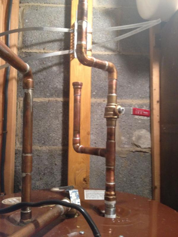

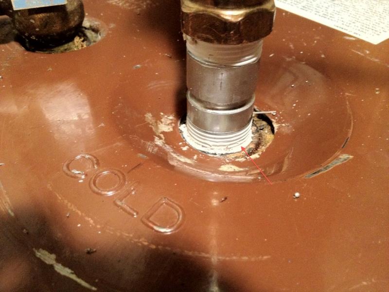

    Even before the system was pressurized, and only exposed to the full stream of water coming in, I started seeing seepage at the top of the dielectric nipple. After consulting google, I cut my pipe, unscrewed everything from the nipple, cleaned the water inlet threads with a wire brush, and applied four wraps of teflon tape in the right direction, with pipe dope on top of it. I tightened everything down really well, giving it a full turn more than intended because of the angles that I needed to preserve to mate with the water line and my expansion tank mount. I soldered everything back in place, and there was no more seepage at the top of the dielectric nipple. I let the tank fill completely with all hot water faucets off, and everything seemed to be okay until I noticed the tiniest little drop of water poking through the pipe dope at the base of the dielectric nipple.

    All of you will know that it's difficult to tighten anything once it's hardpiped in place, but I really didn't want to cut the whole thing out again, and I was pretty confident that I had applied the tape and dope correctly, and had tightened things sufficiently. Nonetheless, I heated up the tee fitting just above my threaded female adapter, and forced most or all of another turn with an 18" wrench while the solder was molten. I turned everything back on, and found the same seepage.

    I would start by running a thread chaser or tap down the fitting to clean the threads, and then instead of re-using the possibly bad fitting, I would use a brass nipple with good quality pipe dope.

    The only guarantee with something like JB-Weld is that it would be a hell of a lot harder try something else when it still leaks.
    The brass nipple accomplishes the same thing as a dielectric nipple, but the threads as you suggested are more likely to conform to any flaw in your heater's threaded fitting. It is also more beefy, so you can use a sizable pipe wrench on it to get some leverage. Just don't twist it in hard enough to tear the top of the tank open.

    @cacher_chick, thanks again for your suggestions and explanations. After opening everything up again (routine for you guys, but traumatic for me), using the pipe tap as suggested (it helped but couldn't go deep enough), I took a really good look at what was left of the threads. At the narrowest point, there were only two solid threads in place, exactly where my previous seepage had been. I hemmed and hawed but in the end decided that pipe dope would probably loose that battle and JB MarineWeld would be too thick to get between the threads.
    So I used a brass nipple as you suggested, covered the threads with loctite 271 (red), and screwed it in as tight as I could. I soldered everything back together yet again, and kept the water off for the full 24 hour cure time. When I sheepishly turned everything back on--with a mind to do some serious flushing of the tank--there were no leaks. I'm still monitoring things, but I've found no problems yet.
