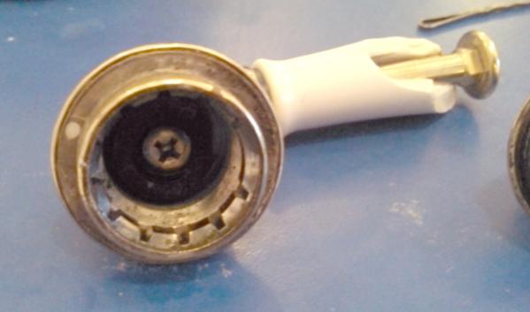

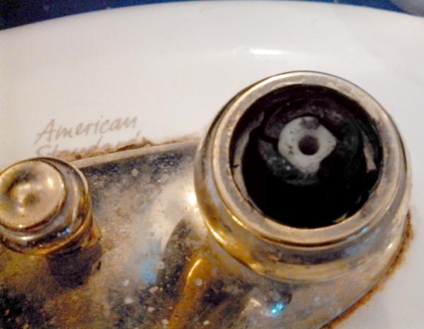

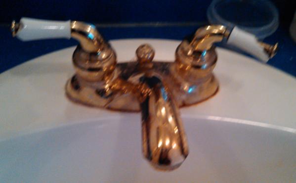

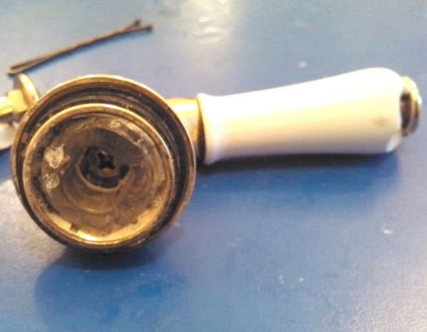

    Hello, I am new to the forum and hope my post will lead to results for a DIY project. A Price Pfister faucet in our bathroom has been broken for years. The kids somehow snapped the handles off the faucet, which still works, but the handles fall off on occasion, and they have become chipped because they have fallen.
    First I need help identifying this Price Pfister faucet model. We bough it from the long gone Home Quarters Warehouse in 1999. I am trying to figure out what internal part(s) I need to fix these faucets, as well as where to get replacement porcelain screw-in handles. Or should I get a whole new faucet system?

    Looks like a Moen Monticello, not PP. In any case, polished brass is on the outs, so replacement handles for an old faucet may be hard to come by. Lets see the cartridge to confirm, then check with moen.

    Call 1-800-BUY-MOEN. Tell them the handles have broken, and you are the original owner. THey will probably want copies of those pictures to verify the model.

    Part number for the hub plastic piece is Moen #97556
    http://www.moen.com/search?search_sc...ch_terms=97556
    As for the handles, I don't see where they have the polished brass but this might work for just the porcelain
    http://www.moen.com/search?search_sc...ch_terms=97559
