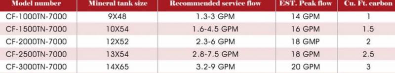

    Quote Originally Posted by Kent Leigh View Post
    Any concern with the GAC at 2 cu ft. when sizing for 12 GPM peak flow rate?
    On the softener, I will rarely exceed max flow rate of 7 GPM. I anticipate in the next 5 years that I'll exceed 7GPM twice a year, and not to exceed 12 GPM at all.
    Regarding sizing for the house for future buyers, I plan on taking my softener and GAC with me if I ever sell!
    The GAC system has a much lower service flow, this is based on organics, THMs, VOC, etc removal to a specific amount. As you can see by the chart, the GAC service flows are much lower than the softeners. Peaks are nearly identical.
    And with 4 showers, just do the math, what if you had guests, and had the laundry going, the dishwasher, and a couple of showers, maybe the kitchen sink. It is not too far fetched to see the flow rate quickly goes up much higher than 5 gpm. There is also code to consider. The water treatment equipment must be sized to the house, not to the number of current occupants.

    Hi Dittohead, just picking up on your last comment regarding service flow rates on the GAC. Today I have assumed a 2 cu ft GAC would meet my needs, but with the chart you provided, that will give me a 6 GPM service flow rate. This should be adequate for normal use, but in the cases where i have a peak flow rate exceeding the 6 GPM, would i expect chlorine bleed? Again, assuming peak flow rates at 12 GPM (more like 7 GPM but sizing for future visitors or changes to the house that would increase our normal peak).
    Going from a GAC at 2 cu. ft. to a 3 cu. ft. system is an expensive proposition (extra $2-300 up front costs).
