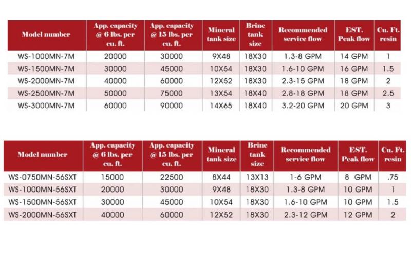

    For a 4 bedroom house, the 7000 would be the smallest I would recommend. A 3 Cu. Ft. may be more accurate on paper, but you have to consider the low flow efficiencies as well as the peak and SFR potentials. By exceeding SFR very rarely, and using the peak as the actual capability of the system, the 2 or 2.5 cu. ft. system would be a better choice due to its low flow efficiency, which is what the house will see 95% of the time. Check out the chart below for more information on service flows, both low and high, and potential peak flows. Again, exceeding the recommended flow on a rare occassion does not damage the resin in any noticable way. If you constantly run the system above the recommendation, it will damage it over time. This is a legitimate concern for commercial applications when the system is undersized, or sized to the peak and not the recommended max flow. Residentially, the difference may be 15 years of resin life instead of 18 years... if you exceed the recommended flow on a very regular basis. Also, the 5600 is not recommended on any larger than a 12" softener tank.
