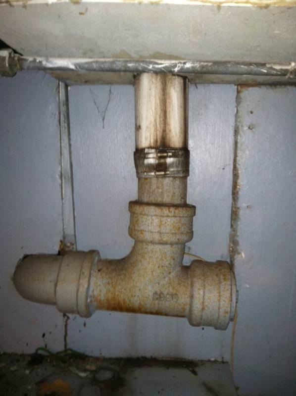

    Could this be the problem? It is sloped back, seems to me if anything it should be sloped the other way. I tried pushing up on it & it does not move.

    While a picture can be hard to tell exactly, but yes, if that is the main line going out to the septic tank, and it slopes backwards into the house, it will constantly end up getting clogged up. The only good solution is to either replace or substitute a new line out to the tank that has the proper slope to it.

    Sorry, I should have been a bit more descriptive. That is the end of the line ( or beginning ). On the other side of that wall the tub & sink empty into that main pipe & they both drain great. That Tee is sloped slightly backward and I’m thinking maybe water & waste is pooling right there under the toilet & creating the problem. I don’t know if that is by design, or if it has settled. I did push up on it and I can’t move it.
    I’m wondering if I could solve the problem by replacing what you see there with PVC, cutting the iron pipe on the other side of that wall & splice it into it with the PVC. I would cut the iron pipe about two feet from the wall & make sure the new PVC has plenty of slope in the right direction. I would add supports (what I would call hangers) tying back to the floor joists to prevent future sagging. And top it off with a new toilet, hopefully a Toto Drake CST743. The existing toilet is really old & almost impossible to keep clean, especially since it is really hard to get it to fully flush.
    19,204
    If the rest of the line is sloped properly, then yes, you should be able to replace that section. Keep in mind that it was probably at the proper slope when installed, and since it drooped, there may be additional problems in the horizontal runs above. I'd check those before I went to the trouble to just install a patch that may not solve the problem. Support to keep things from moving anymore is critical.

    Well, I went out and got the parts & pieces that I think I’ll need today. I couldn’t find the Toto Drake locally, so I settled for a Kohler K-11813 Cimarron. I rented a chain cutter for the old iron pipe. I thought about using an air grinder with a, or several cut off wheels, but then thought about all of the sparks under an old house & the gas from the septic tank…I don’t want to die that way…lol. So, I rented a chain cutter. It’s raining here right now & for the next few days so I can’t work on putting my garden in. So, it’s toilet time…I’ll let ya know how it turns out & maybe, but hopefully not ask more questions about this unwanted project.

    Well, I got that section of pipe replaced & the new toilet installed. (That chain cutter was a major B!!) After I cut the main line & before I replaced anything, with that section wide open, I washed my hands in the sink & the tub gurgled, bad sign. Sure enough, I got everything back together & first flush didn’t flush, the bowl just filled up & went down slowly like usual. There was plenty of empty pipe to take that water. So, I went down & drilled a ½” hole in the top of my new 4” PVC horizontal run & it flushed just fine several times, but water came out of the new hole. The existing old vent is off of the sink. I would think it should be on the main line. It is just an iron pipe going thru the roof with no cap on it. About 6 years ago, before I had the tank pumped the first time I blew the vent out with compressed air & it bubbled up in the toilet.
    I’m thinking about running a snake down the old vent pipe that goes thru the roof & then add a vent cap to it. Wish I could put a brush or something on the snake that is same size as the pipe inside diameter for a second or third run through it, but I can’t find anything like that. Also, I’ll have to replace the pipe that I drilled. I’m thinking about adding a 12 inch tall vertical pipe on the new horizontal PVC & put an “in wall vent” on top of it. Sound logical?
