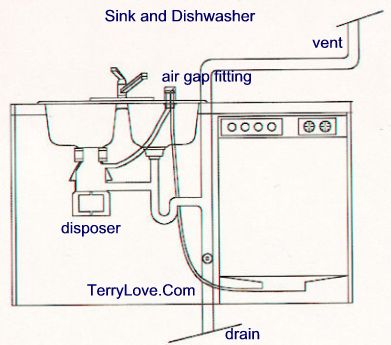

    Hi all,
    I'm roughing in for a new kitchen sink/base cabinet and was wondering what the experts recommend for where the drain should be brought up. The kitchen is gutted, so I have a lot freedom on where to put it, except it's a easier from down below in the basement to put it no closer than 16" off the wall. This would put it more towards the front of the base cabinet Is this ok?
    As far as left-right position goes, i saw this picture on the site which shows the drain coming up on the side, rather than the center:
    This is pretty much what I will have except my dishwasher will be on the right. This looks pretty good, so what i'm thinking is bringing the drain up all the way to one side and forward of the sink center. Anyone see any flaws with this design?

    Sorry, dishwasher is to the LEFT of the sink...
    23,518
    YOU want the drain on the side that is farthest from the disposer. If you are bringing the drain up through the floor, how will you avoid having a ""S" trap? The dishwasher location is irrelevent.
    12,419
    We put the drain in the back wall.
    The drawing above is just meant to show how things drain. Which is hard to do with a front on picture.
    for a deep sink, we stub out the sink trap arm at 16" above the floor.
    You you have a single bowl and disposer, then offsetting either way 8" works.
    If you have a double bowl, then aiming for the bowl drain opposite of the disposer works fine. You can miss by a few inches and the swivel of the trap will still pick it up.
    I need to ask here. I offset my in wall work 10" to the left for the dual bowl kitchen sink, but alas the disposal side of the sink is on the left as well. Am I screwed?
