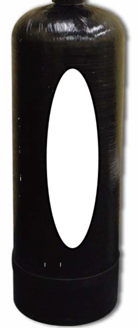

    The cutaway tanks are miserable to make, but we have done many for dealers displays. Cut an oval hole in the side of the tank, spend too many hours trying to clean up the edge, or finally go to mcmaster and get edge guard. Name:  edge.png
Size:  12.8 KB Then use some thin plexiglass and spend another hour with 2 part epoxy, glue it from the inside. Cut the epoxy just an inch or 2 larger than the side hole.
    It can be wetted if it done correctly, I would not put more than a pound or 2 on it though. Again, this design does not need to handle pressure, only flow.

    I'm not following this part; Then use some thin plexiglass and spend another hour with 2 part epoxy, glue it from the inside. Cut the epoxy just an inch or 2 larger than the side hole.
    You are gluing the plexiglass with epoxy and yet cutting the plexiglass 2" larger, and doing that on the inside of the tank?
    For the visual of the effect of backwash, brine draw etc. you need at least 20 psi.
  13. #28
    Jan 2012
    1,707
    Backwash does not take any pressure to work. Like I said, I build open to atmosphere portable exchange tank regeneration systems. It only requires flow, it does not require an ability to hold pressure to get a proper 20-30% bed expansion on a resin bed. Same goes for the injector. The injector assembly requires some pressure, but the tank itself does not.
    Try this, cut an oval out of paper, now cut another one 10% larger, see how easy it is to install it through the hole so that is can be mounted to the backside. Gluing it to the inside gives it a nicer look, and does not require that the plexiglass be perfectly cut. You may be thinking of a round hole, you would be correct in the assumption that it would not fit, square, rectangle, oval all work fine. That is why manhole covers are round.

    The ones I made were simply plexi that I gasket end and bolted through the tank using ss toilet tank bolts with the rubber gasket.
