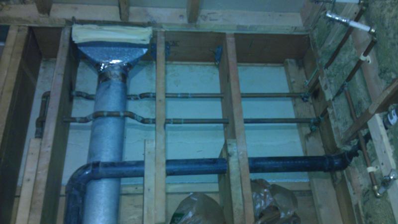

    You have asked a loaded question, because everyone has their own opinion about what is best, and why.
    You have copper piping, which pretty much lasts forever in most homes, unless you have acidic water. PEX is becoming more common primarily because it is faster (cheaper) to install, and raw copper prices are through the roof. CPVC is not widely used for new construction or re-piping here in the Midwest, but I have used it for smaller jobs with no issues. It is also inexpensive and easier to install than copper. One thing to remember when installing PEX or CPVC is that the I.D. is smaller than the equivalent copper pipe, so it is often suggested to install one pipe size larger than what is commonly recommended with copper.
    The pressure tank you have now is fine as long as the bladder is good and you maintain the air charge. Do you need the room you will save by replacing it with a smaller tank? If so you might consider a CSV instead of the controller for the variable speed pump. The electronic well pump controllers have a pretty high failure rate, so I wouldn't suggest switching over.
    If you have natural gas available, you should research the cost difference in heating water with gas vs. electric. In most (but not all) of the U.S., gas is less expensive. Depending on your water, an electric tank might last over 20 years. There is no guarantee that a new tank will last any longer than the one you have. The main thing to consider is what might be damaged in your home if your current tank starts to leak? A pan with a drain line can be cost effective if the tank is in or above a living space.
    If the iron content of your water is relatively little, a softener alone will take care of it. What is more adequate for treatment would depend on the results of a complete water chemistry analysis.
    If I were you, I might look at what will minimize the chances of an expensive plumbing failure, like heavily corroded piping or old washing machine hoses (likely to burst). If your existing plumbing is in decent condition, you might be better served by putting in some updated fixtures like shower valves with anti-scald technology or looking harder at your heat/cooling losses and weatherization.

    My question to you is why do you feel it necessary to replace 40 year old copper? In most places, copper will last longer than the house.

    Why do you think you have to "update" the plumbing? In most cases people only update it when they want to make changes, otherwise the only update is to change to better looking faucets or fixtures. I do not know what "salt for iron" is, because the salt only regenerates the resin.The iron content is filtered by the resiin and is "removed" when the backwash water flushes it out.

    Thanks everyone for your help and advice. As for why I want to update the plumbing, it's because the copper plumbing running through this 2nd floor bathroom is now exposed. I removed the floor since this bathroom shower was leaking and damaged the floor. So now that I have all of this plumbing exposed, I figured if there are any improvements to be made, now would be the time.
    I'm not sure if this picture I'm uploading will work, but if you can see it, you can see the existing copper has multiple joints as they made their way around the floor HVAC duct. All of these joints are green, so I'm thinking that's of years of corrosion happening on uncleaned joints. Not sure.
    Also, if you can see the pipes that T off and go down the wall from the sink supply in the photo. That is how my kitchen gets it's water. And it takes 1 minute 45 seconds to get hot water to the kitchen now. So not having that pipe go all the way upstairs, then back down the wall into the crawl space, I think I can greatly reduce the length of the hot water pipe going to the kitchen.
    I'm not trying to do PEX, or any particular solution. It seems the more the read on these choices, the more confusing it is.
    I'm only trying to find out what is the "best" solution. I'm not so concerned about price. Although I'm not wanting to waste money, I think paying more for the best is worth it with jobs like this. I don't want to find out in 5 years that I have to tear out that bathroom floor again because something I installed is now toxic, or leaking, or otherwise causing problems.Name:  IMAG0554.jpg
