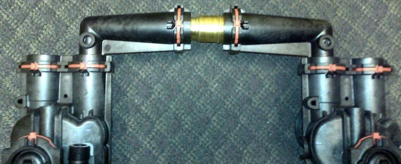

    Options, definetly go for the gravel underbed. I am not a fan of the Vortech distributor, no need to go into details, I prefer a gravel underbed. I would recommend the 61601, 90 degree 2 pack, and a 1x1-1/4 sweat connector 41242-01, and a 1-1/4" x 1-1/2" sweat connector 41243-01, swet the 2 together and use the 90's to make a perfect connection betwen the GAC and softener tank. See the picture below.
