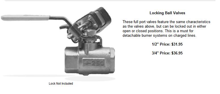

Hammerlane
275
13
Have a shutoff inside the house and then one outside....put a locking shutoff on the outside if you are worried. WHat is the issue? Are you concerned that someone will try stealing the natural gas or that someone may turn the valve on and the the gas flow without you knowing??
