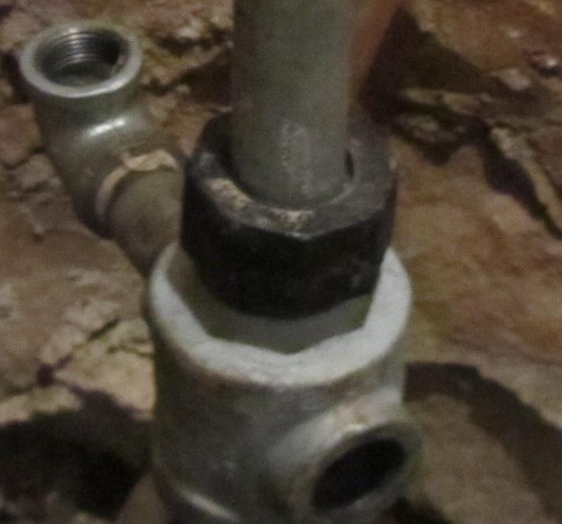

    So I have a J7 3/4 hp Goulds pump. They also sold me the control valve and the cross piece. We had guessed at this with our first shot and think we had too much pressure going down my casing therefore blowing off my leathers. I read the pump book again today for the 5th time and have come to realize that I need to run my pressure switch off this control valve, which we did not do the first time. The pump book says it should have like 32 psi going down the casing. That seems easy enough to do. My question is how do the pipes run? Like from the cross to the tank to the control valve, or from the cross to the pump to the control valve? I have 3 holes on my pump. The one on top I believe is my main water line and the other 2 are for discharge? The hole in the middle is 1 1/4" and the bottom hole is 1" i believe. Can someone PLEASE help before it starts to freeze my dirt so I cant shovel it back into the hole?
    Attachment 17848Attachment 17849
    Why is there a tee in the Jet drive line ? Are you using it as a output ?
    Seems like it should be on the pump outlet, Or am I missing something ?
    if it was really "blowing off my leathers" then that must be a site to see. Please post pictures.

    Theres not a T in the Jet drive line. Theres a T on top of my casing.
    I wouldve loved to have been down there to take pictures of this event but I dont fit down my 2 1/2" casing.

    If it has a packer then the casing is the Jet drive line. Is it not ?

    I am no expert, But seems to me that the only reason to have a tee where yours is, would be for a gauge to measure the Jet pressure.
    Normally if you are using a water pressure/flow regulator, then most likely it would have a Gauge on it.
    It sounds like you may have a valve that restricts the output of the pump to get the jet pressure up.
    That should work, but the valve needs to be closed some or the jet may never get enough pressure to get the water flowing.

    It's hard to tell exactly what you have from the picture you posted. I'm going to try and keep this as simple as I can. On a deep well jet pump, you have a "DRIVE" line and a "SUCTION" line. The drive line is always smaller than the suction. Typically the drive line is 1" and the suction is 1.25".
    What you really need is a real well head, but since you have a 2.5" casing you can no longer buy the proper casing adapter (well head). If you could convert the 2.5" pipe to 3" you could use a goulds AWJ3 casing adapter and it would be much simpler.
    Just remember this-the suction pipe goes directly down to the jet. The drive pipe is the pipe that sends water between the casing and the jet-it's what the leathers are being used to divert into the nozzle of the jet.

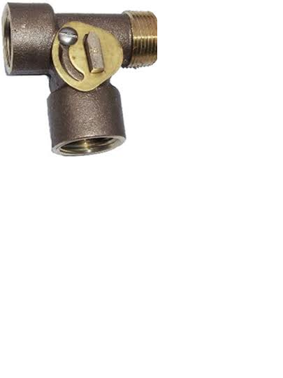

    When running a multi-stage goulds jet pump the backpressure needs to be about 40-45 psi for a two stage. I would also recommend getting a real regulator and getting rid of that one you have. Look for the AV21 regulator. There is one made specially for horizontal pumps, I can't recall the exact model number off hand.
    [edit] OK, I just re-read your post. Your pressure switch has nothing to do with the jet pressure-leave it as is. It always needs to be connected to the "tank pressure", or the same pressure you have in your house lines. Normally they are connected to a port on the pump which reads the same pressure after the pump. Ditch the regulator you have and get an AV-21 regulator, it has a port on it to feed the line to the pressure switch.
