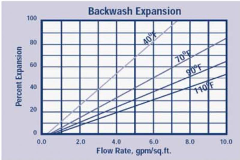

    The DLFC controls the expansion of the resin bed during backwash and limits the downflow, which will minimize waste. Unregulated system would waste a lot of water and the cleaning process would not be done. If you simply pushed the whole bed to the top of the tank and onto the top screen, the resin will not have expanded, it will have simply shifted. Resin bed expansion allows the resin to reclassify, to move around, and to be physically cleaned.
    As to the top screen, these are typically light duty screens, not intended for abuse. It is not unusual to see top screens collapse when a DLFC is done improperly. Please see the chart for proper expansion rates based on water temperature. We use generic charts for sizing DLFC's, but they should be adjusted for the application and for regional water temperatures. Of course a balance has to be made in areas where water temperatures vary regularly. Higher temperature requires more water to achieve the same bed expansion. Cold water uses less (the water is more dense, it cn lift more).
    Hope this helps.
