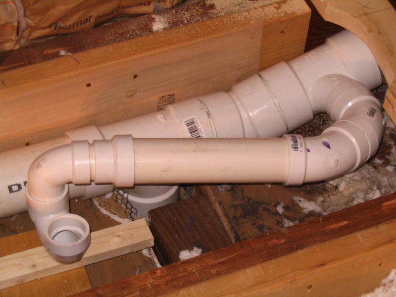

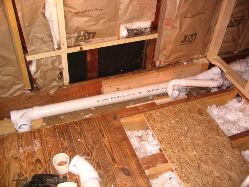

    hello everyone and thanks for looking. I am plumbing in a bathroom (sink, toilet and acrylic tub with mortar bed) in my attic, but because of limited space between joists and not really wanting to cut in or notch them i came up with this arrangement (see photos and please don't laugh). the question is will it work? and any venting issues? I realize this is probably not up to code. Also looking for comments on internal toilet flange, okay or not? i will need to use one as a female flange will put it way above the finished floor. also Name:  010.jpg

    The tub isn't vented. The 3 x 2" sanatary tee installed horizontally is not to code. The 3" sanitary tee just behind the tub drain is installed in the wrong position and can not be used like that under any circumstances and if the 3" running to the right is supposed to be a vent, it is flat and won't work. In short, if you have glued that mess up already, you have wasted your money and time.

    Quoted from OP "the question is will it work? and any venting issues? I realize this is probably not up to code."
    For me, that is the operative sentence in the entire post. Hopefully, he plans to get a permit and an inspection which would probably have negated the need for the post. I am always perplexed when someone realizes that what they have done does not meet code and yet still seems to want reassurance from professionals that would never even consider doing work like that. It also goes to show just how ignorant most folks are of the underlying reasons and principals of sanitary plumbing.

    Well after reading the replies, i guess my only option is to tear out ALL the existing plumbing including the original plumbing put in when the house was built (1951). There are no vents to the first floor bathroom (the original) other than the vent stack itself, I know because i have gutted the walls, and i have never had a problem. the only other vent in the house is for the kitchen sink on the other side of the house. I am not a plumber, i drive a tractor trailer for a living. i was simply looking for a solution other than major renovations to the house. As far as Code goes, this is Baltimore, Maryland and the majority of the houses here are pre 1931 construction, if all renovations were done up to Code, they would probably have to level the city and start over.

    Your best option is to hire a professional plumber to design and make your renovation up to code. Your last statement is almost certainly incorrect. I a major city such as Baltimore, I am sure that renovations are required to be inspected and made code legal. You are probably correct that the original plumbing and electrical in pre 1931 construction is not up to modern standards, but when changes are made, these must be brought up to date.

    Most places would "grandfather" any pre-existing plumbing, but any new installation is required to meet the current code.
    12,431
    We're not saying to tear down the home. Just use a few more fittings on the new work.
