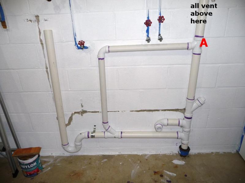

    As mentioned by others, you cannot re-vent into that stack the way you propose. The photo below was on the site about a year ago and is a pretty good example of a washing machine/ utility sink drain setup. This photo assumes that above fitting "A", no other fixtures from above floors are draining into that stack.
