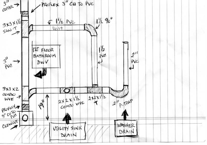

    I am in the process of moving my washer and utility sink to another wall in the basement. The current washer and utility sink connections are in the basement concrete floor and the washer drains by backfilling through the utility sink drain and then gravity draining (due to no venting, I assume).
    My design has the utility sink and washer moved to the same wall where a 3" copper DWV is. This DWV services a 1st floor bathroom toilet, shower, and sink only. I have had 2 plumbers look at connecting into the 3" copper DWV and both said in can be done. That said, I have a few questions as I have never done this, although I am an avid DIY type that has taken on multiple projects and am determined to 'do it right'.
    The questions are as follows:
    (1) Any glaring problems with this design (attached drawing)?
    (2) What is the best way to cut 3" copper DWV? hacksaw, sawsall, etc?
    Further information.
    - The total distance from the DWV to the utility sink is 2.5ft and the washer drain is 5'. Would a need exist for a vent at all here?
    - The main sewer drain to the street is directly below the 3" DWV, so does this influence the desing in any way?
    Thank you for your time.

    ooops. Not intuitively obvious here. Lets try this as attachment....

    From what you have stated, the 3" line is a drain for fixtures on the floor above. This means that it cannot be used as a vent. Your basement plumbing needs a dry vent going up through the roof. Alternatively, a new vent could be connected to the existing stack, but the connection would have to made at least 6" above the flood rim of the highest fixture draining into the stack.
    12,445
    You will need to vent both the washer and the sink, and not by using the nearby waste stack.
    The two vents can combine at 42" above the floor, and then either go through the roof, or to a vent on the "next" floor at 42" above that floor.
    The pipes above the santee are all vents. The wast line goes through the floor.

    My initial though after reading as much of the above postings as I could take, is that you are out of your "comfort zone", and may be "exceeding your level of incomptence". In your original drawing, the sink is NOT vented and you cannot tie the vent back into the drain line. As far as existing vents are concerned, you apparently do not know what you have and we cannot tell you HOW you can vent the new washer/sink location.
    12,445
    I would guess that the existing plumbing hidden in the walls is in fact plumbed properly. Just because you see one or two vents through the roof, that doesn't tell you what the plumber has done in the walls.
    Here is a drawing showing two bathrooms stacked with only one vent. Does seeing one vent through the roof tell you anything?
