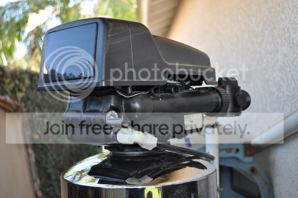

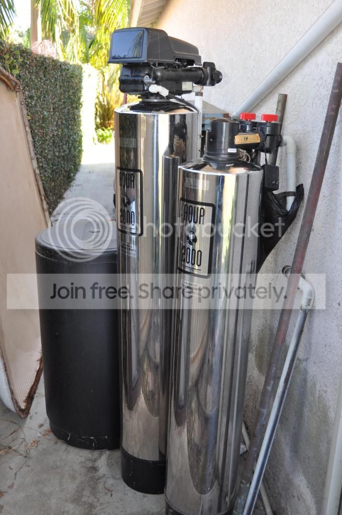

    First off Hello to all from Los Angeles CA. I have been browsing the threads and found a ton of useful information for my newly acquired water softener system install. A buddy of mine lost his home but prior to that offered up his 3 year old water softener system. I went ahead and took photos of it installed hacked away at pipes and re-sweated.
    Now comes the fun part , the install. Ive got almost all the parts needed to get the install completed, I project about 5-6 hours by myself with no help or major hicups, but who knows with little ones it may very well be a week long project. I know how these devices work but am no expert by any means and contacted a local water softener company to get a quote on a service as my buddy said it was up for service. The representative came out and did his spiel to try and sell me a new system which I politely thanked and refused. He quoted his company could do the service and start up of this system for $380.00. This seems a bit high for what is done, or is this a reasonable price?

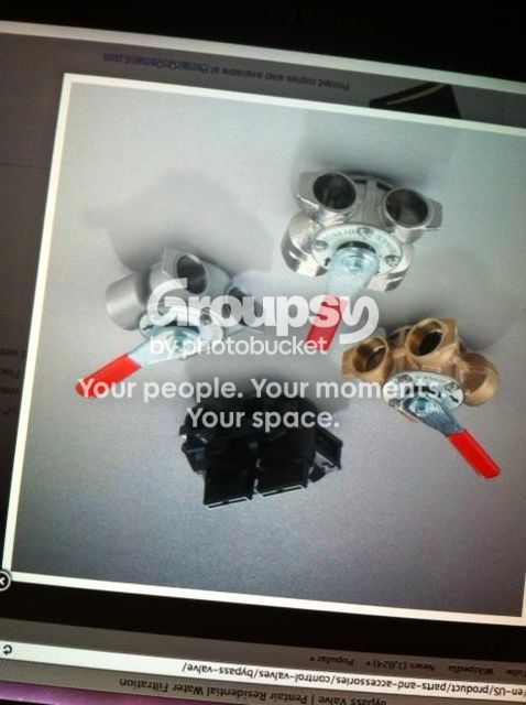

    [/B]The only question I have on the install is the use of bypass valves. I see there are valves on the inlet tank but would these suffice? I've read about the stagnant water which can build up when using certain types of configurations with the ball valves, such as when they are used in an H configuration? Ive seen some by-pass valves which if I can locate locally I will utilize.
    [/B]
    I have posted photos of my bling bling system and brine tank, along with the by-pass valve I would like to use. It will be placed outdoor under a 3' 1/2'' overhang which should protect it rather well against the elements and the 12" of rain we get a winter here.
    Im having trouble uploading photos, I will try something else on a follow-up post to this thread.
    Thank you all, any suggestions or ideas are always appreciated to make this install and restart as smooth as possible.

    I'm thinking this valve would be ideal.
    6,792
    You have an Autotrol valve and need their by pass valve for the model valve you have.
    The other piece, a filter, has a Clack in/out head on it with its own by pass valve. And yes, use the make/model specific by passes rather than building a 3 way manual type.
    The picture of by pass valves is of Fleck by passes and you can't use any of them.
    Sorry, I now see the Autotrol valve has a by pass valve on it....
    Jan 2012
    1,707
    The bypasses you posted are not compatible with the system you have. Those are Fleck bypasses, you have an Autotrol valve, and a Clack In/Out head. Both units already have bypasses installed, so you could simply install the units after getting the proper plumbing connectors specific to thoe valves. What type of plumbing do you have? The plumbing connectors are relatively common.

    In the pictures, both units have the bypasses already. Each unit should have a bypass, and they do.
    Yes to the type of plumbing. Both units have plumbing connectors available in copper sweat type. Be sure to consider code as to the electrical ground. Both of these bypasses will break the plumbing ground. http://www.pure-aqua.com/product_fil...%201228354.pdf Here is a link to a manual for a similar system. It uses the same plumbing connector.
    The Autotrol is part # 1001670 for 1" sweat kit.
    The clack connector for 1" sweat is V3007-02LF,
    Hope this is helpful.

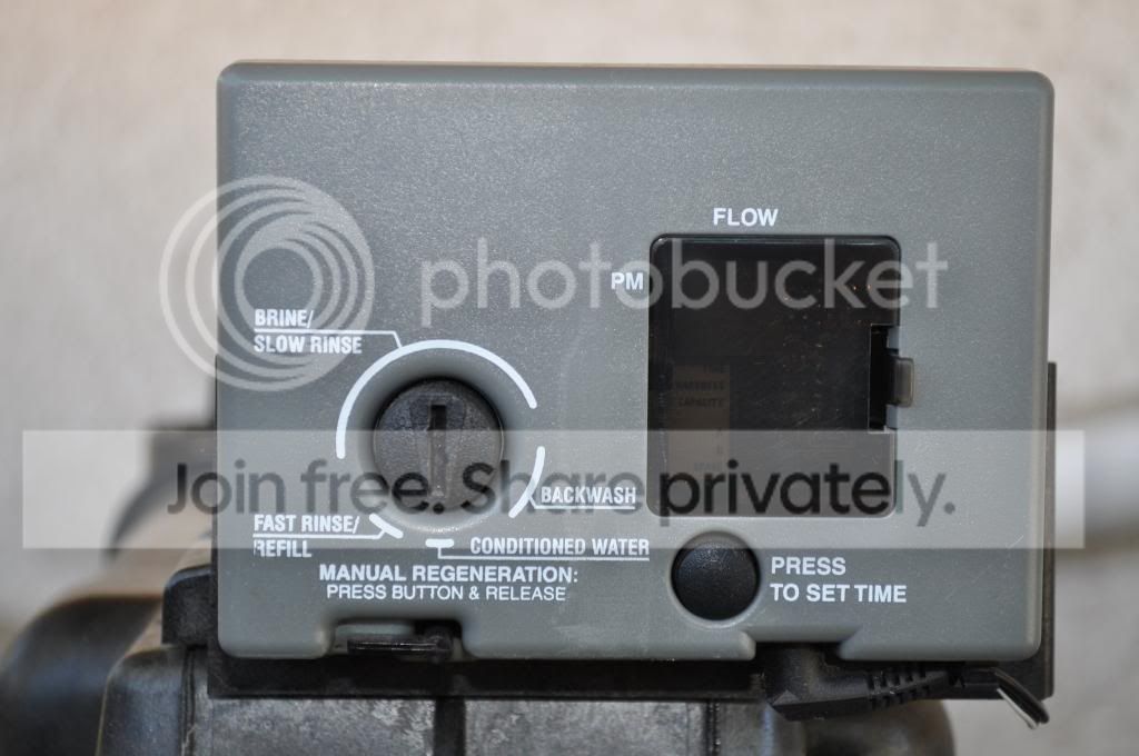

    Wait I have both these fitting attached as they sit, so this is resolved and install can move forward.
    Now if I understand correctly, the electrical plug is a simple plug in and that's it, the ground is already on attachment.

    When you are ready to turn the water on, have the control valve in backwash and turn on the water about a 1/4 flow until it starts going out the drain line. Then open it up watching the water for color or resin. If color open it full open but shut it down some if you get resin. Run it until any color disappears then step the control through the cycles to Service and run water a tub to flush the lines.
    You need to program the control valve based on your hardness etc. and how much water you use per day.
    BTW, you solder those fittings on the plumbing without them connected to the by pass or control valve. Otherwise you melt plastic...
    You need to add like 5 gallons of water to the brine tank before adding salt. And I suggest keeping the salt level about half full instead of filling the tank and then if there is a problem you have to remove salt to be able to work on it. It also helps prevent running out of salt if you check the level more frequently than not.
