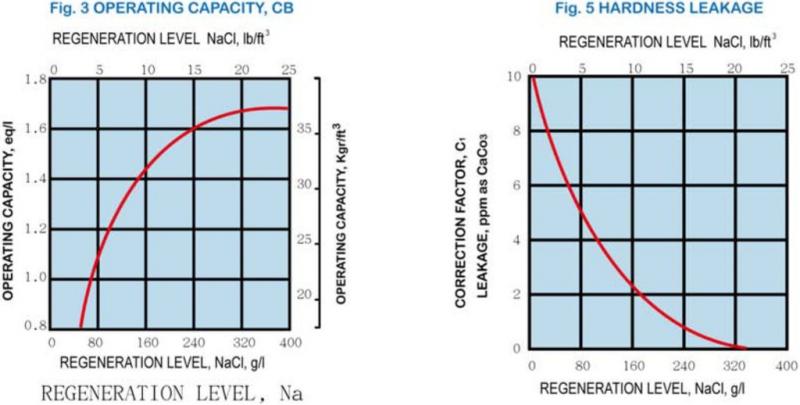

    Salt settings are more than just grains per gallon. Water efficiencies, hardness leakage, time between regenerations, etc all have to be considered. Systems can be set to as low as 3 pounds of salt per cubic foot, but the water quality is usually below customers expectations. 4 pounds per cubic foot is the minimum most companies will do so as to maintain quality, and 6-8 pounds almost ensures near perfect quality. Below is a hardness leakage chart. With all this being said, if you are happy with the results and you are efficient, then it is all good!
    My major problem is when companies set softeners to use 10-15 pounds of salt per cu. ft, this gets out of the reasonable efficiency range and ventures into unnecessary waste.
    Name:  capacity leakage.jpg
    An article written by one of the best minds in this industry (Chubb Michaud) explains it far better than I ever could. It goes into a detailed analysis and reasoning behind maintaining truly soft water vs. slightly hard water. http://www.wcponline.com/pdf/1203Michaud.pdf

    I used data from the SST60 data sheet which is similar to yours but "better".
    Wonder what the chance is that the SST60 data is not really accurate.
    SST-60 C-100
    Leakage Leakage
    NaCl
    (#/CF) (ppm) (ppm)
    2 2.1 3.7
    3 1.3 2.1
    4 0.9 1.4
    5 0.7 1.2
    6 0.6 1.1
    7 0.5 0.9
    8 0.4 0.8
    9 0.35 0.7
    10 0.3 0.6
    12 0.2 0.5
    15 0.1 0.4

    Hardness leakage is actually very comnplex, the charts are simple guidlines to help us understand the potential or likelihood of hardness leakage. Resin age, quality, fouling, flow rates, remaining capacity, etc. all have to be considered. For resideantial applications, most people are very happy with 10 PPM or less, commercial applications that require hardness <3ppm is where it gets exteremely complex, maintaining below this hardness requires considerabnly more expertise, fortunately this is not common and rarely an isue in residential sitiuations.
    My recommendation, use standard resin numbers and capacities, use no less than 4 pounds of salt per cu. ft., and you will be fine.
