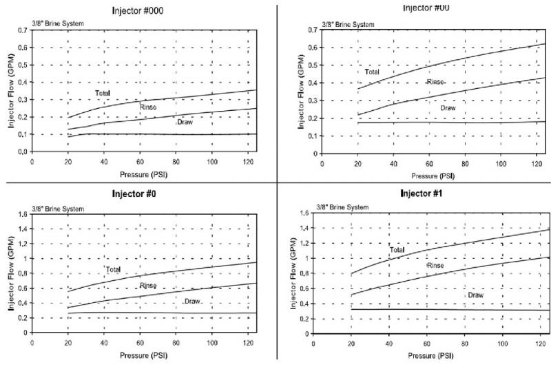

    *edit* someone please explain to me the process and why it takes 60 minutes for the brine draw step.
    Jan 2012
    1,083
    Brine and rinse is as stated. The brine draw rate is determined by several factors including pressure, injector size etc. The actual brine draw should be done in approximately 15 minutes. (please no debate, every manufacturer has a different formula for efficiency etc, this is just a general comment). The brine draw occurs by the softener directing the water through a venturi injetor which creates a vacuum on the brine line, thereby drawing in the brine solution from the brine tank. This dilutes the brine depending on the system design and the injector efficiency. The water in the brine tank should be removed completely in about 15 minutes to allow for proper contact time etc inside the mineral tank. Once the brine is removed from the brine tank the system is now considered to be in "slow rinse". The water is still going theough the injector but is no longer diluting brine, it is just slowly rinsing the resin bed. This should take approximately 30-40 minutes to remove the brine from the tank, the remaining is a safety factor to allow for some variances in brine draw, injector efficiency, etc. It wastes very little water so brine draw time is not usually considered a critical setting except in areas where the waste water must be hauled off, then we will set the brine and rinse cycle a little more carefully. I have posted the common injector sizes for the 7000, the 5600 are very similar in their draw and flow rates.Name:  7000 injector draw.jpg

    Here are my settings, comments wanted (5600SXT meter, 2 cubic foot of SST resin, 12x52 vortex tank);
    DF= GAL
    VT = dflb
    CT = Fd
    NT = 1
    C = 38
    H = 40
    RS = rc
    RC = 120
    DO = 10
    RT = 2:00
    BW = 10
    BD = 50
    RR = 12 Should I set this to 10 ?
    BF = 7
    FM = t0.7 Is this the correct Turbine Meter? (has to be this or P0.7 Paddle Wheel)
    Dittohead, what is the ratio of water used through the venturi injetor vs water through the brine line from the brine tank ?
    My interest would be shortening the amount of time for the brine draw (time being more important than the small amount of water). On the above graph you posted (thanks by the way)... The RINSE line is the rinse after the brine has been completly drawn out... not the rapid rinse? ***edit*** explain the two lines; is the DRAW line (from brine tank) and Rinse line (through injector to sewer) happening at same time?
    6,356
    You want all the usable brine out of the salt tank in the first 15-20 minutes of the brine draw/slow rinse cycle. The slow rinse water flow is used to cause that to happen and it continues to flow to rinse the resin with the brine and then to rinse the salt water out of the resin tank.
    Depending on how much salt you use, you can shorten the 60 minutes some but if you do so too much, you may not get the salt out of the resin bed with the rapid rinse and you'll have salty tasting water. IMO you are better off to not micro manage this.
