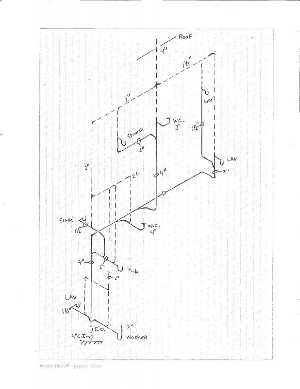

    Default Adding second floor bathroom
    Anyone see a problem with my riser diagram? Full bath on main floor and second floor stack tie into main trunk line with 4" wye's. Redoing all the plumbing as it was originally CI with threaded galvanized. No flat vents in this design. All DWV is sch 40 PVC.
    Thanks
    Jan 2008
    3,150
    The drawing would make my inspector happy.
    Whether you can plumb it that way in the house remains to be seen.
    14,202
    Huh?
    There is nothing wrong with that drawing. I concur with the above statement. Good job.
    Nov 2010
    Maine
    2,940
    You don't need 4" anywhere there
    DIY Junior Member Endmout's Avatar
    Nov 2012
    Louisville, KY
    Existing sewer is 4"CI coming up out of the floor. Could save a few $ but I'm going with 4" all the way through.
    Pretty sure it will fit this way as I have a lot of it in already.
