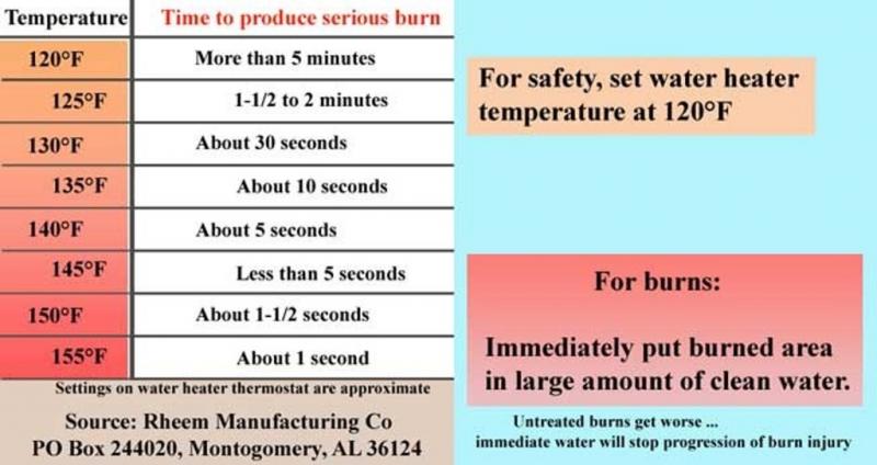

    Thanks Mikey, great information! so few people understand this important part of plumbing. I have attached the Rheem hot water temperature/scald chart. Excessive temperatures are very dangerous and not allowed by most plumbing codes, but without it, the water heater can become a pathogenic nightmare. The installation of a tempering valve is critical to protect guests, elderly, children etc from potential severe injury or death. Name:  hot.jpg

    To do it right the water heater should be set at 160 with a tempering valve also set at 160. Then every fixture served should have an asse 1070 device installed at the point of use because legionella can hid in the piping itself. Recirculating is also key for runs longer than 100' but there are those that think that people have the god given right to expose their family and friends to scald burns and codes are just there for someone to make money off of.
    Plumbers protect the health and SAFETY of the public. Hacks living in motor homes on wheels don't give a crap and have no problem giving unsuspecting folks bad advice.
