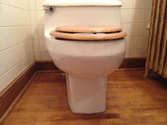

If you post a picture of the old bowl, that will help.

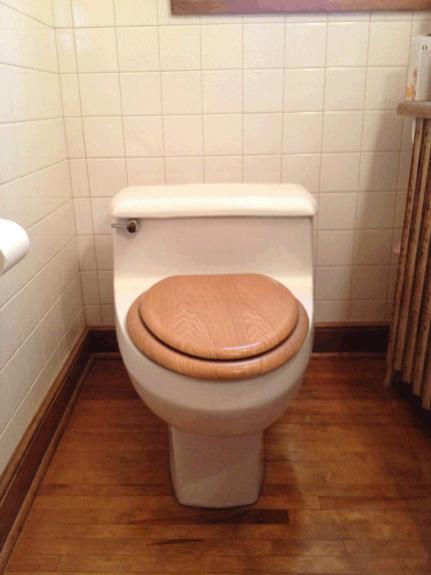

First pic shows the location of the water supply if you squint at the base near the floor on the left side. Water comes up thru the floor, not the wall. I tried to measure I think it is 6" from the center of the unit? I could be wrong...
Second pic shows the toilet cubby, radiator to the right.
Toilet at base of tank is 19" wide; lid is about 22" wide, whole thing is about 22" tall.

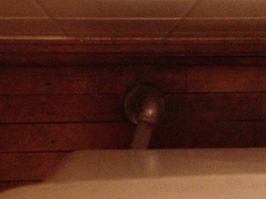

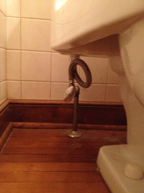

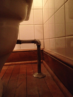

PS Do me a favor and shoot a picture of that water supply location, and measure it from the centerline of the toilet to the toilet side of the supply pipe, so we can get a sense whether it will fit next to the Vespin. If the pipe will fit, they make shutoffs with just a little quarter-turn knob rather than the big handle, so if the pipe fits next to the toilet, you are golden.
Here are the pics. I think, though I could be wrong, the pipe comes out of the floor at 7 inches from the center of the toilet. I'm not sure you can see it well in the pictures but the pipe turns 90 degrees before the flexible hose, and it is ANGLED away from the wall. Pic 3 is taken from above the tank looking straight down but it may be too dark to see, dang camera phone.

I think at 7" you'll be good. Might need to remove the 90 or at least shorten the nipple and maybe turn the valve to make the handle easier to get at.

You might want to consider modifying your water supply. <snip> I would sure get rid of the galvanized pipes.
Dang I forgot about that, you are absolutely right. I have slowly been replacing the galvanized piping; I guess it's the toilet's turn.

The galvanized pipe under the floor may be OK for the toilet supply. Even if it is somewhat corroded inside, it will still provide ample water to refill a low flow toilet quickly. My reference was for the exposed pipe. I wouldn't even use copper exposed. Ideally, the water supply is located in the back wall 8" off center. This may not be a practical alternative for you; it wasn't for me either. Other that having something to clean around, there's really no problem with the pipe coming out of the floor like yours. Not knowing what kind of access you have to the plumbing under the floor, I can't really say what you will need to do. Certainly getting rid of all the galvanized pipes in the house would be wise, but it is expensive even if the is open access below.
