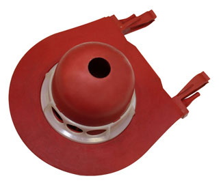

    Both Korky and Fluidmaster make adjustable replacement 3 inch flappers with instructions on where to set the adjustment for particular brands and models.
Size:  6.5 KBName:  korkyflapper3060bp.jpg
    I don't have flush problem, it works great in that respect. I have a flush valve seal at the tank leak.
    I think that my second tank is being shipped from Mexico! HD actually suggest removing and returning the whole toilet as that would be faster than just ordering a replacement tank. I told them that was out of the question.
    Luckily my leak is small and some rolled up paper toweling turned end for end once or so a day works. It appears to be slowing down even more unless I'm mistaken.
