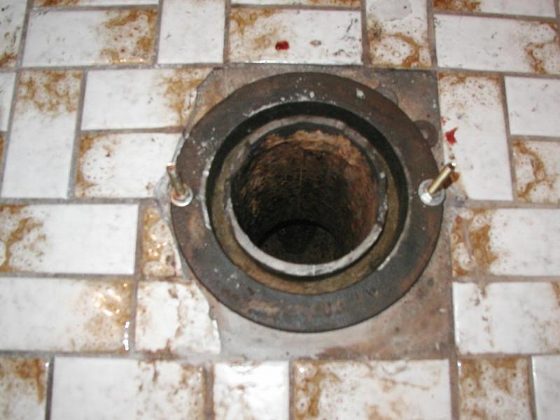

    I google a picture that show the same model of flange as the one in my house. Name:  P1010265.jpg
    The flange is remains 85~90% good after all rust removed. Since the flange is soldered on the pipe, it will not move around with normal touch. But the concrete foundation has 1/4" to 1/2" gap around the metal pipe. It will move a little be (flange and pipe move together) if I force it.
    The bottom of flange is now above the concrete floor surface 1/4". After new tile installed. the top of the flange will be 1/8" above new tile floor.(but the back side will be a little lower than front side, about same as new tile floor surface.) I got a "Push-Tite™ Gasketed Closet Flange"Name:  C886ga.jpg
