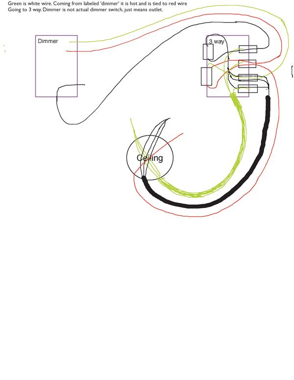

    Okay, here is what I'm up against in this living room.
    I have a multimeter and all of these wires have been tested. All of these wires are hot in both switch boxes. The only thing that isn't hot in the diagram is the neutrals running to the 3 way from the ceiling box. The light in fan works with black and blue tied to the three blacks and white tied to the three neutrals that make one in the ceiling box. It also works with the black tied to independent red wire, white to neutral and blue tied to the 3 blacks tied together.
    I am not concerned with where I turn on the fan just as long as the dimmer works and the fan works. If there is any more information needed if you can tell specifically what info I can give you I'll do my best to get it. Thanks
    Edit: At the top left hand side of diagram where I stated that, "Dimmer is not actual dimmer switch, just means outlet", I meant to say that the box labeled dimmer in diagram just means switchbox. Also, wiring travels from dimmer to 3 way to ceiling except for neutral that is shown in diagram from ceiling that travels to 3 way.

    Edit from last post. The blue from fan only has to be tied to 3 blacks tied together (hot) for light to work. The red is not hot in ceiling. I have tested this with multi meter and it's not hot. It is hot coming from box labeled dimmer to 3 way however. So I guess red from switch to ceiling controls right switchbox in diagram? but what in the heck controls the dimmer? Confused!

    The black in the fan is the motor, the blue is the light. If you tie them together under the same hot you cannot use the dimmer.

    I have it all working now! Will report back what I did soon. Kinda of get it but would like to see if someone can inform me how this is working exactly. @ Actiondave, I did tie the blue to the black hot in ceiling and black to red originally but didn't work. Maybe wasn't connected well, I'm not sure.
    DIY Junior Member Steven77's Avatar
    Oct 2012
    NY
    10
    Okay, I have it working but I am admittedly ignorant on the subject. I would love to increase my knowledge on the subject so if anyone can chime in it would be greatly appreciated.
    I had the black and blue from fan tied to the 3 blacks (hot) in ceiling. I switched the blue from there to the red that was by itself in ceiling box. The red runs to the box labeled 3 way on diagram. It runs to the switch on the bottom of the box. By turning off that switch it powers off the light but fan still works by pulling the chain. The box labeled dimmer does not power at all with that switch off. With that switch on I can use the dimmer.
    My confusion is with the switch located in the box labeled 3 way in diagram. This does not appear to do anything. I can turn it off but can still use dimmer and fan. What is it's purpose? I think it controls the outside proch light but am not positive because I think that bulb may be blown. I will need to test that.
    So I think one of the hots (the red wire) in the box labeled dimmer is not traveling to the box labeled 3 way. It is going directly to ceiling box unlike what I drew in daigram and this controls the dimmer? Am I correct? If so, why would they wire it this way?
