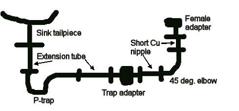

    Latest update on this. Still don't have a solution.
    I'm going to try the following. FYI I have a bronze DWV fitting in the wall with male 1 1/4" pipe threads.
    If anyone cares to offer their $0.02 on this I would greatly appreciate it.
    Starting from the sink tailpiece:
    1. Plastic extension tube, plastic slipjoint nut
    2. Plastic p-trap, plastic slipjoint nut
    3. Plastic extension tube, plastic slipjoint nut
    4. One side of a 1 1/4" trap adapter. Bronze slipjoint nut
    5. Other side of trap adapter. Sweat connection to 1 1/4" copper
    6. Short 1 1/4" copper pipe, sweated to adapter and 45 degree copper elbow
    7. 45 degree copper elbow, sweated to 1 1/4" copper pipe on both sides
    8. Short 1 1/'4" copper pipe, sweated to 1 1/4" female pipe thread adapter
    9. Female pipe thread adapter, attached to bronze male fitting in wall stub out.
    Engineer chassis's Avatar
    Sep 2005
    SE Pennsylvania
    339
    It's been about 2 hours and the trap has not leaked, even with sustained hot water running through it! Yippee! I plumbed it using the sketch above, but without the extension tube between the p-trap and the trap adapter. Had to use teflon paste in all the threads (plastic and copper) in order for it not to leak. What a bugger this was.
