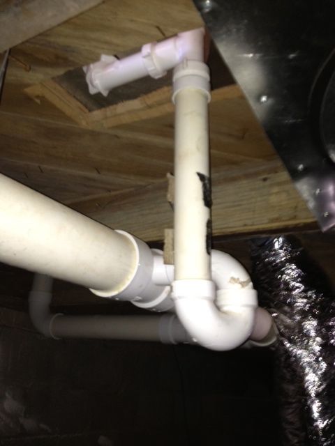

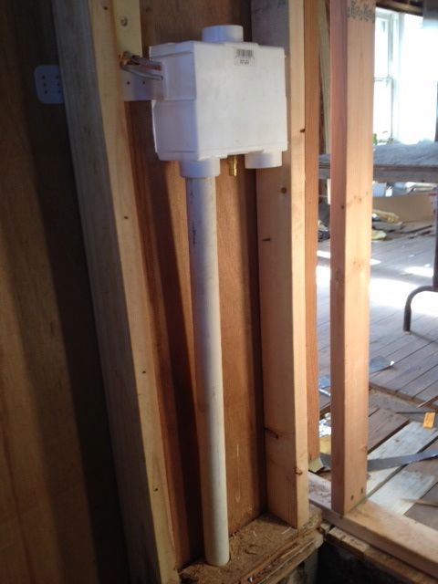

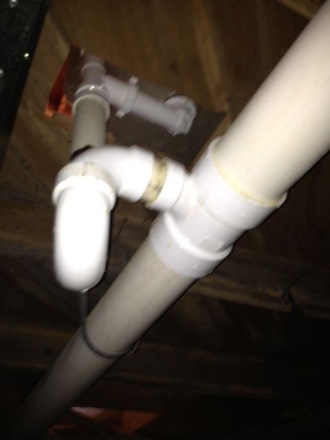

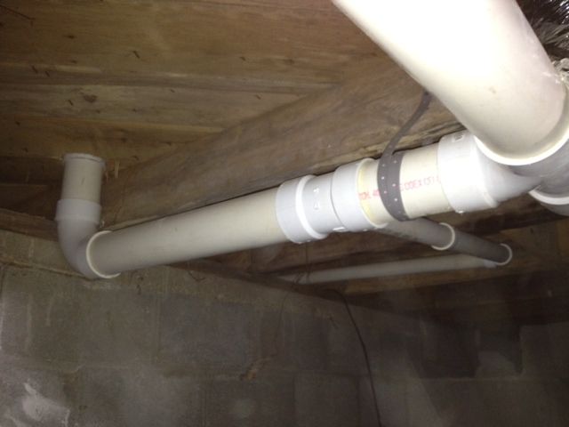

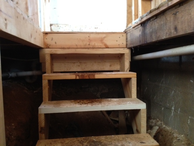

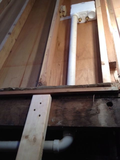

    First off thanks to everyone for all the great information on this forum. I have read a lot of great information on this site over the past few months. I have attached several pictures of a recent drain and vent install. The installation is on a remodel that was completely gutted. I will be running all the water lines with uponor. I will say the drain and vents were not installed by me. A local plumber was hired to do this. I am a little worried about the work that was done. We even had a big discussion on vents. The plumber wanted to stub all the vents up in the attic and vent them there. I disagreed and said it was the wrong way to do it. The argued and said they do it all the time. I said if people do this all the time then why do I see vents stubbed out of the roof on every new house that is built. I will try to give details on each picture below. I am really concerned about how these drains and vents were done.
    The first two photos show the washer box drain going down with just a 90 fitting. I thought you had to have a p-trap within 30" on this. Also there is no vent. I thought you had to vent the washer. Also the kitchen has no vent, thought it had to be vented also.
    The third photo is showing the p-trap for the washer box. The other drain you see there is for a bathroom sink.
    The fourth picture shows how far the washer drain really runs before it even goes into the p-trap. Its hard to see but the p-trap is to the left of the stairs. All the pipe to the right is coming off the washer drain, goes behind the stairs, then into the trap.

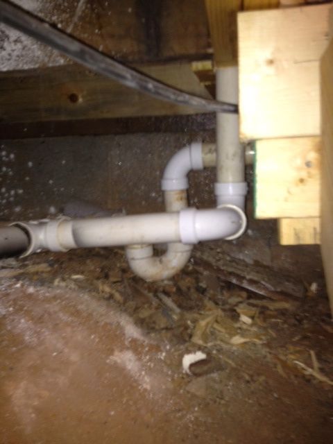

    The next few pictures show some of the other drains. The first picture shows the toilet and vanity drain. The only vent in this bathroom is on the vanity which is upstream of the shower and toilet.

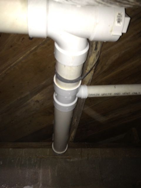

    The second picture is showing the same toilet and vanity drain from a different view with clean out.
    The third pic shows the shower draining it downstream of the toilet.

    I have seen nothing that would be considered a vent. The guy is a hack, and doesn't have a clue.

    The lack of vents are not the only things that are wrong. He has san. tees on there sides. No vent on the washer. Plus the waste line on the washer should be 2" not 1-1/2". I sure hope you haven't paid him.

    There is so little, if anything, about that system which is proper that it should be cut out and redone to make it right. Every one of those tees in a horizontal drain line are incorrect and would never have passed an inspection. He also has no clue about venting. You might want to call your local building department to have them look at it and addess the capabilities of your "plumber". If he is a licensed plumbing contractor the license should be revoked and if he is not, then the Business and Professions Code, section 7031 states that if you do not pay him, the courts will not listen to his suit.
    12,599
    No standpipe receptor for any clothes washer standpipe shall extend more then thirty (30) inches or less then eighteen (18) inches above it's trap. No trap for any clothes washer standpipe shall be installed below the floor, but shall be roughed in not less then six (6) inches and more then eighteen (18) above the floor
    All horizontal fittings below the floor level should be wyes or combos.
    Santee fittings can be installed in the vertical position.
    Vents extend through the roof. Individual vents can tie back together at 6" above the flood level. In most cases, this would be at 42" above the floor.
    A lav is vented within 42"
    1.5" trap arm within 42"
    2.0" trap arm within 60"
    Most of the 90 bends in the photos are wrong too.
    Long turn 90 on the horizontal, Long turn from vertical to horizontal.
    Medium turn from horizontal to vertical is okay.

    Yes. Built a duplex about two years ago. You pay to have a water meter set and a septic permit is required to get the power cut on. The only inspection we have here is on the electrical. From looking at the pics the toilet should have a combo right? When I first looked at it I thought that is way to tight of a turn. Notice they put the clean out right there with it.
