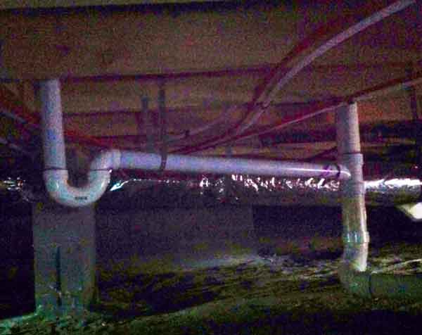

I hired a local plumber to install the drain and waste vent for my new construction home. This is a picture of a drain area I am concerned with. The shower drain (double shower) on the left starts the run and it continues to a toilet drain on the right which continues on to the main line. No vent. I am afraid when the toilet is flushed it will suck air from the shower trap and gurgle. Am I wrong?

Thanks for your reply. Yes, I purchased a building permit through my city which includes elect, plumbing, hvac, etc. I do not think the inspector goes in the crawl space though. Here are a couple of pics of another bath at the other end of the house. The crawl space pic is actually two pictures joined together. I also included a photo of the same area topside.
The drain run starts at the tub/shower and continues to the toilet and then continues to a double vanity. The only vent I see is at the double vanity. Will this work?

Ok someone correct me if I am wrong. No line can be any more than 5 feet from a vent. AKA if you want to use a single vent stack the rest of the lines can not be more than 5 feet away. You can share one toilet, two sinks, and two bath's or showers on one two inch vent. This is max. The vent in the wall can not be at any more than a 45 degree angle. In your photo it is at a 90 degree angle. Once again I was taught this is a no no. You have no access issues by looking at your crawl space so there is no reason not to do this correctly. Tell them to get back down there and do it right.

They must have thought they were putting plumbing in a mobile home, because that is what it looks like. In most jurisdictions, the vent out through the roof has to have an aggregate area, not diameter, equal to the incoming sewer. One 2" vent does not cut it. I hope he gave you a "good price" because he did a "quick and dirty" installation.

Thank you for the replies so far. The plumber who performed the drain and waste vent work is licensed and has a prominent business in my town. His bid was not low. I am having a hard time swallowing all this. The pics I included show only about 25% of the plumbing he did... I am really worried about the other 75% you guys have not seen. I went under the house with a level and did some checking. I found several "uphill" runs. I'm going to meet with my city inspector tomorrow and we are going to walk through the house and I will reply tomorrow with the results.

UPHILL RUN !!!!! Are you Effin kidding me. Maybe in his world water runs up not down. 1/8 inch slope minimum and 1/4 prefered by me.

Also do I see that instead of cutting out the 2x4 and running the double sink drains straight down through the floor where the wall meets they just went in front of the wall? That will only work if your tile guy doesn't mind tiling around them and you don't mind cutting part of the back of your new vanity out and any future installed cabinet also. This is the biggest mickey mouse install I have ever seen

There is a double beam directly under the wall so they could not send the drain down without coming outside the wall. The cabinet maker won't have any problem at all, I already talked to him about this.
