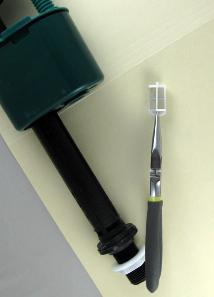

    I have a Gwyneth Toilet that is about 5 years old. This week it decided to act up and wont stop running. When the tank gets full, the water keep coming in.
    Under t he lid are codes THU253s, THU277s, and THU299s.
    I have tried adjusting the water level, but it doesn't make any differance.
    Can anybody tell me what parts I need?

    The tank fills past the overflow and water runs down the overflow. Also, the water line that goes into the overflow tube keeps flowing water into the overflow tube.

    It's a type A.
    12,419
    If it's type A, remove the water supply from the bottom, and using a needle nose pliers, pull out the filter and clean it.
    The screen in the inlet. A needle nose pliers will remove it for cleaning.

    Not questioning you, just curious. How would a clogged filter keep the valve from shutting off?
    12,419
    If you call up the TOTO tech support line, they will suggest removing the filter and cleaning it.
    If you call up the Flushmate tech support on their product, they will suggest pulling the screen and cleaning it.
    It has to do with water pressure. The seal on both these units need pressure to force the closure. If the pressure is too weak, you don't get a complete shutoff.

    Filter was clean. Replace entire valve with the ToTo replacement valve. Looks like I got the height adjustment off by one notch. The water level in the tank is about 1/8" from the top of the overflow. Would like about 1/2" but it's not worth taking it back out to make the adjustment. It's working now.
