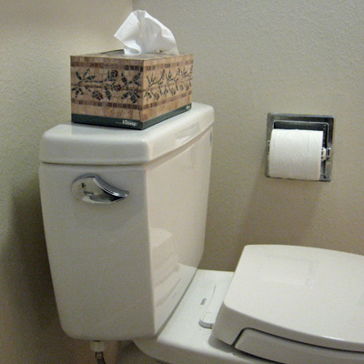

    Hello,
    I refer to this post below with this picture.
    http://www.terrylove.com/forums/show...-by-Jamie-Love
    I am just wondering - what is the proper location for the toilet paper holder - height and distance from the wall?
    I have found some info here:
    http://infodrop.hubpages.com/hub/How...-in-a-Bathroom
    ...Standard Location
    The rules aren't set in stone but the generally accepted standard is to mount the holder on the wall 26 inches above the floor, and 8 to 12 inches in front of the toilet...
    But I am just wondering if there is the most convenient place for it to be?

    For my taste, er, BAD choice of words here, that toilet paper is too far back and the toilet is too close to the wall in those photos at the link.

    I agree - it is not comfortable to grab the roll behind you, but my question is what all people do in general?
    Do they sit on the toilet to grab the roll or they already stay to grab the roll?
    I find mine on the floor all the time, you mean it doesn't belong there? lol.

    Mine looks pretty far from the toilet but it's really well within arms reach.
    14,191
    Normally the paper is near the end of the bowl or at least in front of the bowl.
    However, then the real word comes in, and you may have a tub or shower on one side, a lav cabinet on the other side. A lav cabinet is only 22" deep. So any paper holder installed in the side of a cabinet is going to be pretty close, more like cramped close. The picture above shows a short wall next to a lav cabinet, which prevents it from being farther out by much. And the original paper holder was set up for a standard height bowl. Many new bowls are 1.5" to 2" taller.
    If you have a long wall on one side, you can actually place it where it's it makes sense, what with bowl height, length of bowl and comfort.
    I had one home with 47" between the walls The paper was on the far wall, and seemed fine. My bathrooms at the moment are more like 59". That's a bit far out there, even with my arms.
