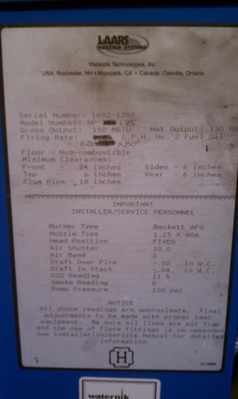

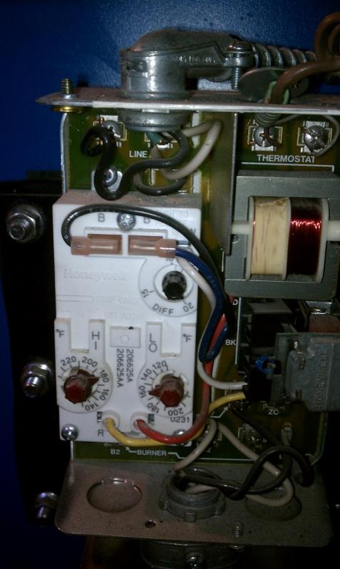

I currently live in Pennsylvania and I'm looking to convert my existing 10 year old LAARS Newport boiler to gas. The problem I'm having is that I'm getting conflicting assessments from 2 local Plumbing companies. Currently my boiler heats the house and the water. The guy I had in Monday says no problem he can covert the existing equipment with a Wayne gas conversion burner and my boiler will still heat the house and the water. The guy I had in this morning says he can also convert the boiler to fire with gas but I would have to buy a separate water heater. He says once I convert to gas that there would not be enough power to do both. He says I would get some warm water but it would not be warm enough to take a shower with. So I'm really confused now and I have a 3rd company coming tomorrow morning.
Now I'm not sure I could be wrong but I think the 2nd guy said there would not be enough BTU's once converted to gas to do both. Does this make any sense to anybody? Is the first guy dead wrong or is the 2nd guy trying to up sell me?
My current boiler is a 150,000 BTU's and they both agreed it was a monster for this house. I've uploaded pics of the stats of the boiler and a pic of the water component attached to the boiler that the 2nd guy says I can't use.
