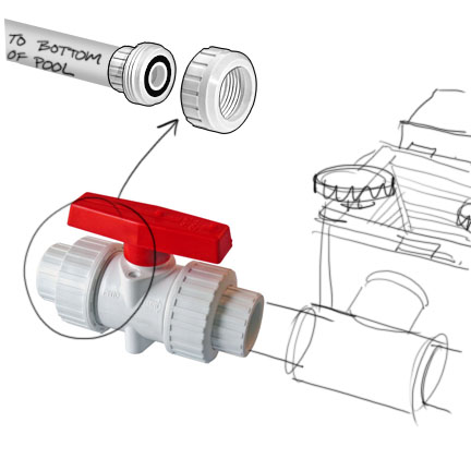

    Sorry, I know this isn't exactly plumbing related to inside a house but I have an issue with my inground pool plumbing when I'm trying to winterize it.
    We bought this house from someone a few years ago (short sale) and evidently they didn't winterize it well enough which led to a cracked line. Our pool has two lines running to the pump. One from the skimmer box and one from the bottom of the pool. They are both dedicated lines and both need to be blown out and sealed at the end of each season.
    I've fixed the crack issue (fortunately it occured right below the concrete patio where I thought it was so I lucked out there.)
    Two years later though, that lower line is a pain to clear and keep air tight. As shown in image at the pump there is a ball/union valve for this dedicated line. I've replaced all the rings and washers once already because the original stuff was all scratched up and wouldn't hold air. I already notice after one season small scratches on the ball surface and worry it will let air out over the winter season and recrack the line. I want to come up with a solution that I can rely on and be easier to seal. Currently I open the ball valve, place an air line from compressor into the opening and shut off the valve as quickly as I can once air bubbles start coming from the bottom of the pool drain.
    My current thought is to remove the ball valve which leaves me the threaded end of the union which is solvent welded to the line. Then screw on "something" that has a one way valve like a schraeder valve or something so I can fill it with air and not worry about it again. Then just remove this ghetto unit when I open the pool and put it in storage for next year.
    Anyone have any ideas on how to do this or any better ideas? I've searched the internet but can't find anything that fits my need.

    Those union nuts are NOT generic, but sometimes the manufacturer will use the same nuts for his union valve AND regular union. If you can find one then just install a bushing and shraeder valve into it and connect it in place of the valve. If you see "bubbles in the water" that must mean you do NOT drain the pool all the way. Jut curious, but in CT, which day of the year is warm enough to use the pool. I would guess it is around June 21.

    Hj, that sounds about what I'd like to do. I guess I just need to find the right threaded union. How would you connect the schraeder to the bushing? can I buy schraeders threaded for PVC or do I need to tap a hole in the pvc and install the schraeder?

    Buy the proper sized bushing with the smallest reduced side. Then you can step down from there with various sized bushings until you get to the final one which should have be 1/2" with a female thread. Install a 1/2"x1/4" brass bushing into the PVC one and screw the Shraeder into it. One of my customers had a pool installed with a propane heater. They furnished an almost "tank car" sized LP tank for it and his 30 gallon water heater. After they filled the pool they turned it on and lit the heater. The next day they were back with their LP truck. He asked them why they were there and they said because the tank is empty. They refilled it and he NEVER turned the heater on again. Every year the LP company would come to check the tank to see if the water heater had burned off enough gas so they could take the tank back. Another of my friends likes to send out New Year's cards with him swimming in his pool on Jan. 1.
