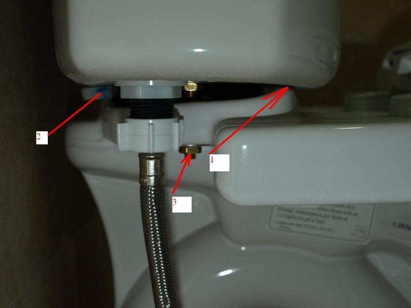

Hello Terry, I was following this advice below and just installed Toto Drake II toilet today. I refer to this procedure - "...it is not necessary for the tank to touch the bowl on all sides, a little gap all the way around is fine... ".
https://terrylove.com/forums/showthread.php?743-Installing-a-Toto-Drake-CST744-or-CST454CEFG-2-piece-toilet-written-by-Jamie-Love
Only problem I have with it - water tank rocks, see my picture below.
I installed tank bolts 3 properly, not to brake the ceramic, but the tank would rock forward and back each time I touch the handle to flush the toilet. This is because there are two gaps 1 and 2 between tank and bowl.
I just placed elastic into gap 2 as a temporary fix, as I do not know if this Toto Drake II design problem or just my toilet has such defect.

The key is it has to be level. Mine just lightly touch all the way around, and they don't rock at all. Rock solid.

It is not a design problem, and it's not likely to be a defect. When you tighten the nuts, you should alternate from one to another. Watch the space so you can keep the tank coming together with the bowl evenly. The three points on the tank and three on the bowl should either touch or have the space of a playing card between them. As WJ stated, the key is level. Mine also touches lightly on the three points. In your photo, it appears that the front was pulled way down and the back bolts were not tighten to keep pace with the front. Back off the front and bring the rear of the tank down so as to level it out. Then take like 3 or 4 turns on a nut then switch to another and do it 3 or 4, and continue this pattern until the tank reaches the points.
29,946
3,460
I would remove the water, loosen the bolts and try to re-center the tank. You should be able to pull it downward more evenly.

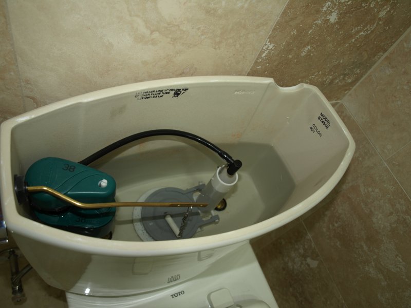

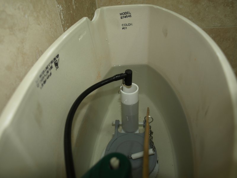

I am totally convinced that it is manufacturing defect. I removed tank completely and was trying to re-install it and water is leveled, you could see it from the picture below, but third point at the back still would not touch the tank.
piezomot
44
Ontario
Here is another picture I made, you can see the water level better here. This back point as it could be seen on my first picture is lower then two front points!PB064603sm.JPG
