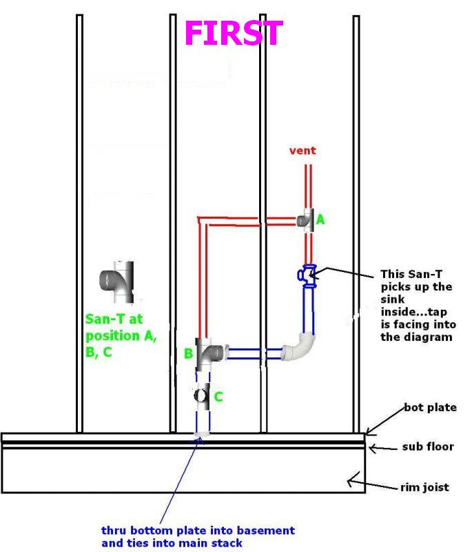

I'd like to see if this is the correct way of adding in a drain for a slop sink in the garage based on the existing plumbing in post #1.
San-T "C" in the first diagram below would be the stub out for the garage slop sink

As drawn the red "vent" up and over to the existing vent is both unnecessary and irrelevent. However, the vertical distance from the existing tee to the new one is too great for a "wet vent". You need to rethink your connection. If your drawing is correct, then the new drain opening is going to be too high for a conventional "slop sink". Including the traps in the original drawings would have just been adding "clutter" since they had nothing to do with the question.

Use your original concept, except turn the lower san tee sideways, then connect your "red vent" to a combo in the horizontal pipe, finally, an elbow out to the sink trap. 18" may be too high for the sink unless you use a "wall hung" one which can be raised if necessary.
HJ...not really following what you are saying. When you say turn the lower San-T sideways do you mean so that the tap is to the right....like the diagram below. What purpose would this do being that then I would have to elbow out to pick up the slop sink trap.
Also where are you saying to connect your "red vent" to a combo in the horizontal pipe??

33,603
1,042
turn ""C" to the left. Then go to a 2 x 1 1/2" combo on its back. Go up from the combo, (#1 would be moved further to the left, then over to the tee using a longer #2. A street elbow into the end of the combo facing out into th)e room will then be your trap connection. You can either install a 2x 1 1/2" bushing before the street ell and use a 1 1/2" ell or put the bushing into a 2" street elbow.

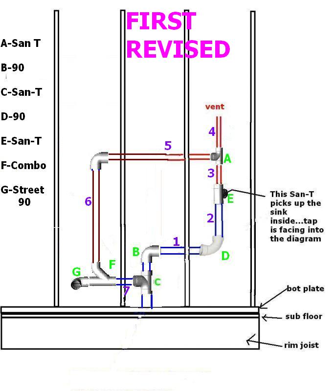

OK...I think I see what you mean now...so Fitting "B" would be an elbow and not a San-T correct?
Wanted to redo the diagram according to your suggestion. Attached is the first way, then the first way revised according to hj's suggestion. In the revised drawing, fitting "G" is the street-90 that would pick up the trap.
Question:
what is the advantage to taking San-T "C", in the first drawing at rotating it like in the revised? why not just stub out from its first orientation?

33,603
1,042
To quote professor 'Enry 'Iggins, "By Jove, I think he's got it." You could not keep the tee's original orientation unless you wanted a lot of pipe outside the wall.
I'm still gonna need the stub-out coming "out of the wall" from the Street 90(fitting G). Don't see how stubbing out from the Street-90 compared to the San-T saves pipe length coming out of the wall.
