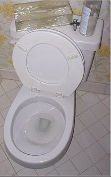

    When I was a kid I had a toilet like this.
    The water tank was located 2 meters above the ground plus inside it had a very unique design. It had some kind of pedestal
    so the solid waste was always going into it, so it has very quick flash as this "waste" was removed right after water streamed into it.
    Nowadays they changed the design, so "waste" goes directly into "small water pool" in it, so when flash starts water would flow, but not the "waste" in it....
    This so called "waste" has different density from water, so it would not follow the water path so quickly...
