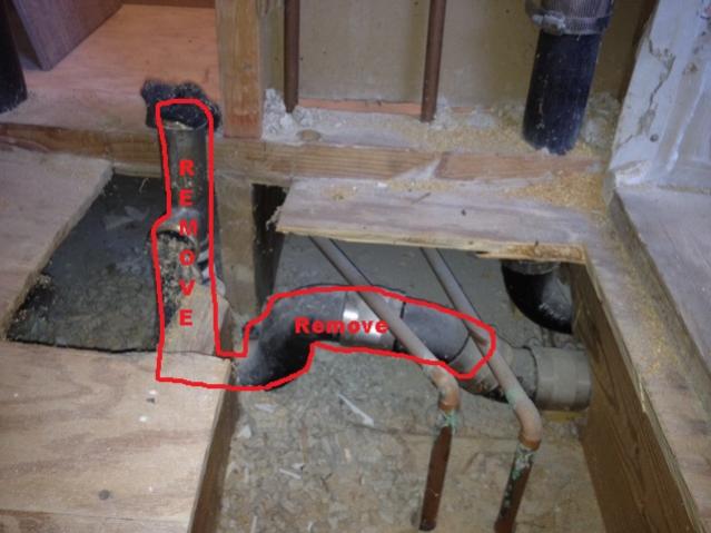

    Good Afternoon! My name is Rafael, I'm new on the board.
    This is the first time I've tackled plumbing. I've done everything else around the house, just not plumbing. I may need to do this job to save some money. I've attached some images here for review. This is my first attempt, so go easy on me. Thank you in advance for all advice and direction, it's much appreciated!!
    First image shows the old tub drain. I've highlighted in red, what I beleive I should remove. I'm proposing putting a Y fitting in it's place for the double vanity and new shower to use the existing drain.

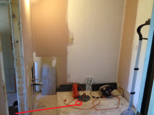

    Second image shows potential drain and venting for the double vanity.

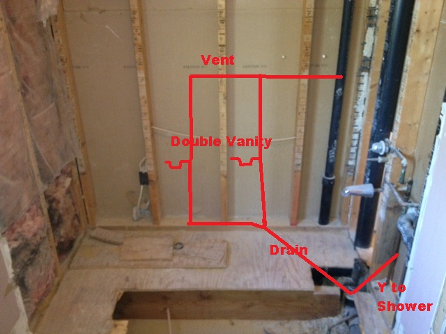

    Third image shows the run from the Y to the shower drain.
    Does anyone see potential issues here? Will this work?

    It looks like you have several issues to deal with. Vents for the shower and toilet to name at least two of them. You really should get a plumber involved because there are a number of other things that have to be done correctly to pass inspection.

    I see floor joists that have been totally hacked out and are pretty much useless. You need to repair the structural damage first and then worry about the plumbing.
    25,653
    If that is a 2" pipe in the background going up the wall, then your tub drain appears to be smaller which means it could be 1 1/2" pipe, in which case it cannot be used for ANYTHING except a single sink drain. The majority of plumbers who do things to the minimum code level would have used a 1 1/2" drain for the tub.

    If the pipe is a 2", then you can drain the two lavs and the shower.
    The lavs can be plumbed using a fixture fitting and combined. The shower needs to be vented correctly; not sure where the shower is from the pictures.
    Two shower heads from 1/2" should be fine.
