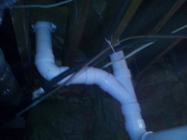

    Attached is a picture of the toilet and vent connections under my crawl space.
    Name:  Toilet (left)  & Vent (right) Connections.jpg

    When one looks at the picture of my pipes in the crawl space, the PVC vent pipe is on the right. The picture shows it going straight up. At the top of the picture would be the bottom of my bathroom floor next to the wall. From the bottom of the floor in the bathroom, the PVC pipe goes straight up (vertical) until it is connected by a mission coupling to the cast iron pipe which then also goes vertical to the roof. The mission coupling connection is about 11 inches from the bathroom floor in the house, which is lower than the top of the toilet bowl. Both the PVC vent pipe and the cast iron vent pipe the PVC is connected is in the wall behind the bathroom toilet.

    The picture I posted was taken by my plumber and is the view in the crawl space. The vent pipe in the picture is on the right; the pipe to the toilet is the pipe on the left.
    All I can say is the new PCV vent pipe that you see in the picture continues straight up through the floor (which is about 3 inches thick), then it continues straight up and is connected by a mission band to the cast iron pipe at a point 8 inches above the bathroom floor. Both the PVC and the cast always run straight up. Both the cast, and the new PCV above the bathroom floor, run up the bathroom wall (wall is behind my toilet). The cast section goes all the way to the roof where it exits.

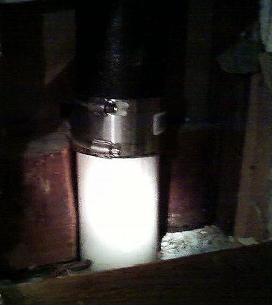

    UPC 705.1.8 Shielded Coupling Joints
    When piping systems are joined by means of shielded couplings, such couplings shall conform to approved standards and shall not be considered as slip joints.
    Your plumber did fine. It's time to cover up the work and finish the job.

    The vent starts in the crawl space as the top of a santee that is positioned in the vertical position, and arms over to the water closet.

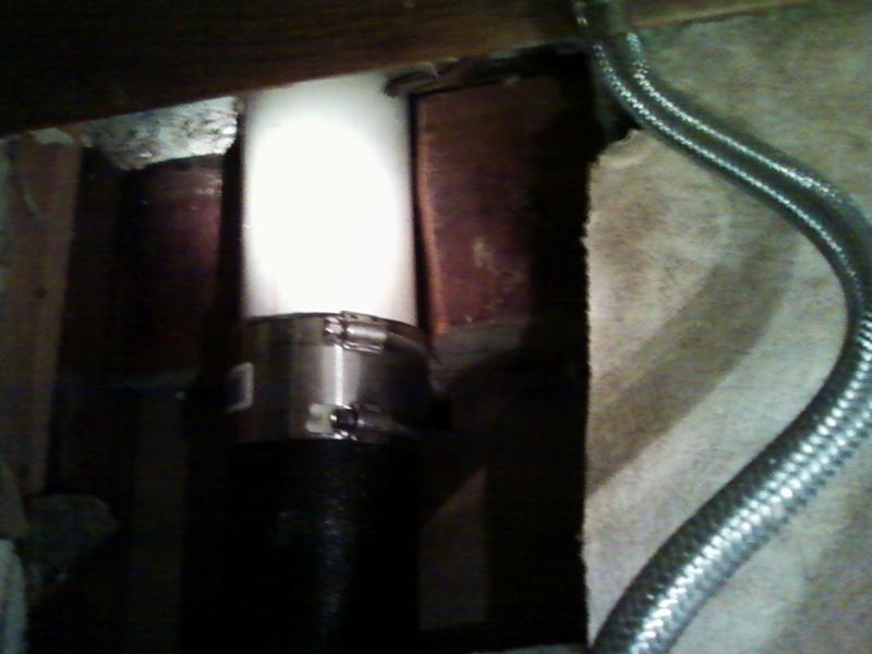

    Adding to my "plethora of postings" is the long awaited photo from inside my bathroom.
    At the bottom you will see the white PVC (as it enters from my crawl space up the bathroom wall)....then you see the mission coupling....then you see the cast iron continuing up the wall and its way Name:  PVC to Cast Connection.jpg
Size:  41.0 KBto the roof.
    Dan
    PS, I just noticed the pciture I've shown is in an upside down view for some reason.
