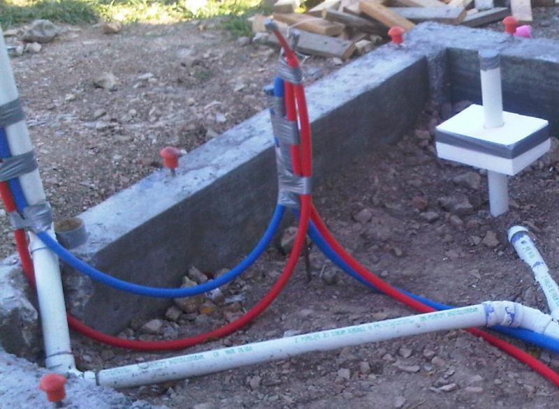

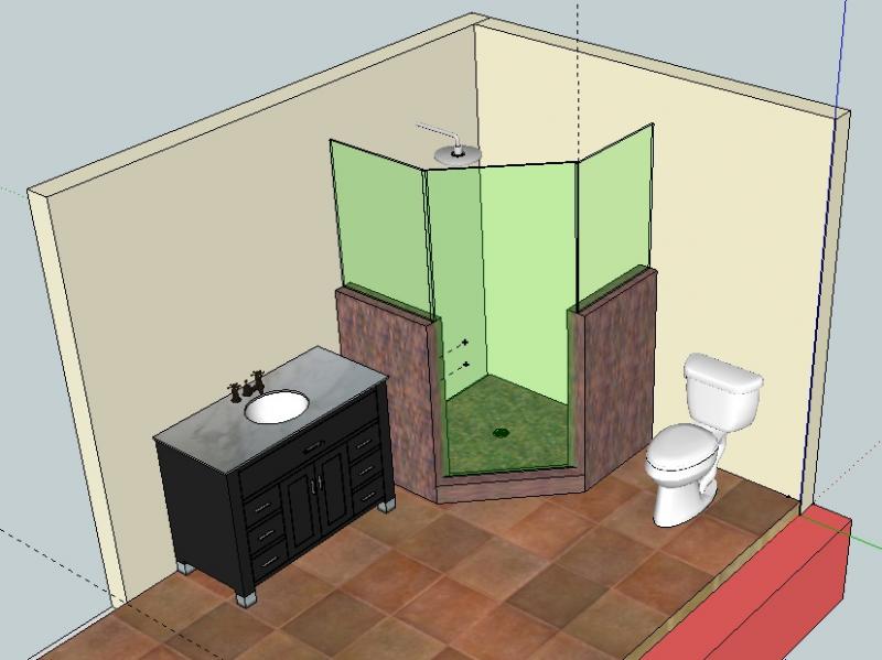

If the space where the pipes are located is allowed to cool to outside temperatures, then yes, it could be a problem. You could finish the room in such a way which keeps that area at the interior temperature. If you are insulating, it must be between the outside and the pipes.
