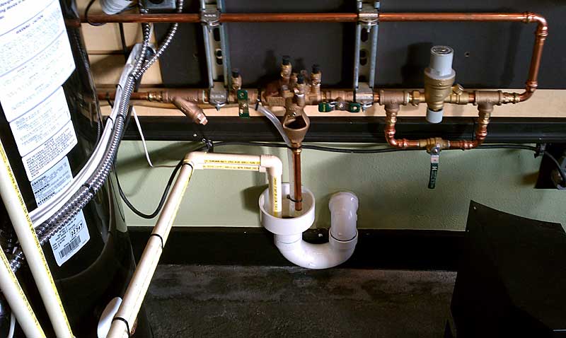

    First timer here. So I've installed a water softener and put in a new water heater. Trying to figure out the drain situation. When the house was made there was a 1 1/2" PVC pipe put in the floor for the A/C air handler. The Contractor has the pipe coming out of the floor about 1' then placed an elbow and a reducer in it for 3/4" pipe. Coming out of the A/C air handler is 3/4" and a series of elbows forming a "P" trap and loosely fiting into the reducer. This is my only place to use for the water heater and the softener. The water heater overflow was originally only piped to overflow out on to the floor but I want it so that if it did would go into the drain. Now adding the water softener I need a place to put the overflow and the drain hose. Can someone throw me a bone on an idea of how to handle all of this? This is in a basement that is used and there needs to be some sort of a P trap for sewage order. I had thought to just get more 1 1/2" pipe and elbows and form a circle with 4 elbows and then put a 1 1/2" to 3" reducer on top and have all 4 (A/C air handler, water heater and 2 softener) hoses and pipes suspended above that to drain. I figured since the softener drain periodically that would provide water to keep the "P" trap with water to maintain the block for the sewer gas. One other thing, the A/C air handler, water heater and softener are all side by side.
    I do hope this makes some sort of sense to someone to give me ideas. If need be I can post a pic online later this evening to provide a pure visual and post a link here.
    Thanks,
    Eric (elmwood)

    I appreciate people chiming in but the point is being missed here. There is a drain pipe already in existence in the basement floor in front of my A/C air handler. It is part of the sewage system which is city (county actually but that doesn't matter it's not septic), there is no P trap in the pipe below ground. The pipe is only 1 1/2". I need to be able to put the A/C drain, water heater overflow and water softener overflow and drain in a configuration so it all fits into the one drain pipe. I know regulations state that I need to have an air gap between the sewage drain pipe and the 4 drains I'm trying to have use this one. I was just looking for some sort of solution to the problem of 4 drain lines using 1 pipe and a good solution to a P trap solution to keep the sewage gases out. Everything I am dealing with here is in the basement.
    The only thing I can come up with is to make a P trap with 1 1/2" and then put a 1 1/2" to 3" reducer on top. This would make it look like a funnel. I am trying to avoid having a weird and large configuration of pipes.

    Maybe you missed a point or two.... IF the floor drain was connected to the sewer line and it has no trap as you say, you would have sewer gas in the basement.
    Now if you don't have sewer gas in the basement, the line is not connected to a sewer and most likely you have yourself a dry well or the pipe is connected to a foundation drain system etc.. If a dry well it doesn't have to be very large for what is now draining into the floor drain.
    Hook up a garden hose and run about 3 gallons per minute of water into the drain for not less than 10 minutes, I suggest 15 is a better test, and see if the drain can handle that but if it does, then repeat the test after waiting 10 minutes and see f it can handle that water flow.
    If not, your softener can not be drained into that drain. If you don't want to do the test, go with your idea and hook up the water heater and softener to the drain and see how long things go well without flooding the basement. BTW, you can install a piece of 3" into the 1.5" x 3" fitting and drill holes in it to create an air gap and connect your drain lines to the top of the pipe.
    And as I said, there will be drain lines in the ceiling and that is where the softener drain should go. I certainly wouldn't want the contraption you are designing poking up in my basement floor...

    We often use fittings to make a "funnel if we need to drain a lot of pipes. A picture posted would have helped us with what you had going on there.
    Frankly, I can't imagine an inspector not insisting on a p-trap for a floor drain. If you have a standpipe now, it would be a simple and quick job to install a p-trap above ground, with the funnel to add your collection of pipes. A Studor or AAV could vent the p-trap.
    And a picture would be nice.
