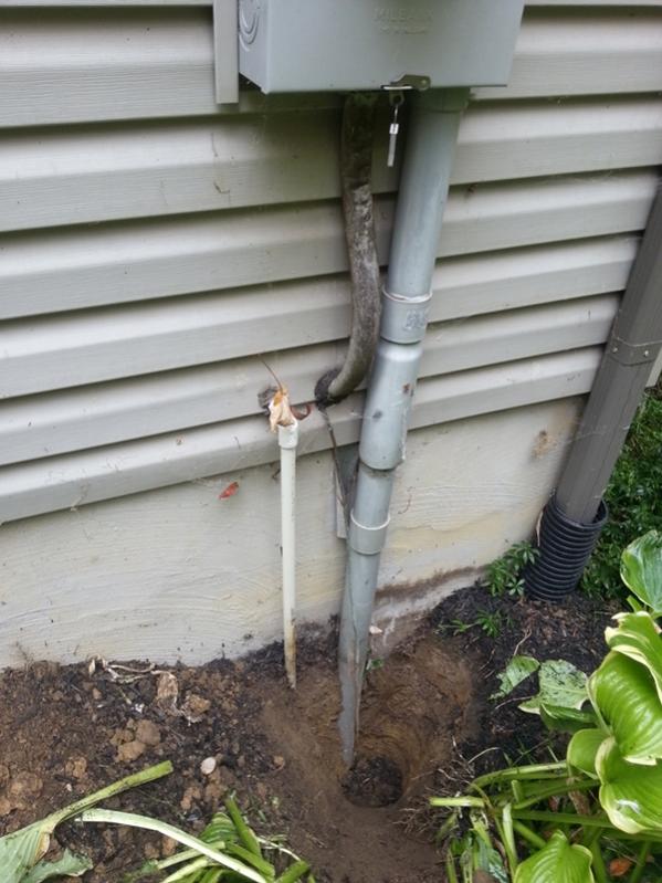

    Hi,
    I have recently installed two antenna's outside on my chimney on the second story of my house (one for OTA TV signal and one cellular antenna). I am attempting to ground these and have installed a new ground rod (8' long) at the chimney base, and will tie both antenna's to it with #10 solid copper grounding wire (per 2008 code).
    Now here's my dilemma. My main house electrical service grounding rod by my meter is about 50' away from my newly installed rod. I was planning on tieing these two rod electrodes together with #6 solid core copper wire (also per code). Unfortunately, I cannot find my main rod by the service to tie to. I have dug down about 3 ft following the main house ground conductor and am scared to go further lest I hit and damage that conductor while searching for the rod.
    So, I do believe that I could tie the secondary rod #6 bonding wire with the houses main wire by some means (vs directly to the rod) but am looking for opinion for best diy method outside of exothermic welding. My opinion on this is that this bonding wire's main purpose is to bleed off any differential in voltage and currents and not necessarily a primary path for a lighting strike, which is what the secondary rod is for, and subsequently I don't HAVE to tie directly to the main service rod. Is that line of thinking correct?
    If so, any suggestions on a good way to tie my #6 bond wire to that main ground wire would be appreciated.

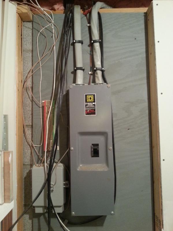

    hj,
    Attached are a couple of pics to help. House was built in 2000. Has underground electric and they had a pretty big trench open at outside service area. Wouldn't surprise me that they drove the rod into the trench bottom before backfill. The ground wire you see at the main service disconnect in my basement (my 200A inside panel is at opposite end of basement) is same that you see coming outside of house and running into the hole. There are no other ground wires anywhere else like at 200A panel or elsewhere, so I have to believe this is the one and the rod is just buried deep.
    After reading a bit more, I am coming to the conclusion to just clean up that wire and connect my #6 bond wire to it with a split nut. What do you think?

    DIY Junior Member fotto's Avatar
    Oct 2012
    Quote Originally Posted by jwelectric View Post
    Connect it to the conductor just before it enters the pipe using a split bolt
    Picture may be a little bad, but the conductor doesn't enter the pipe. If you look closely you can see it running down the side of it (it's a bit off colored due to weathering) at least to where I stopped digging. I guessing if I continued digging further it would at some point veer away from the house a bit to where it terminates to the buried rod.
    I was planning on connecting via split bolt just below ground level so you don't see it. Any issue with that
    Oct 2012
    Thanks for all the replies. I noticed that the telco ground (see top of disconnect pic where the red tag is) was bolted to the disconnect wire which gives me further confidence this is main service ground. Thur pm I ran my #10 down to second ground rod and then ran #6 over to the service #4 ground wire and connected with a split bolt. I may take the advice on running a heavier gauge down from the mast but next spring if so.
