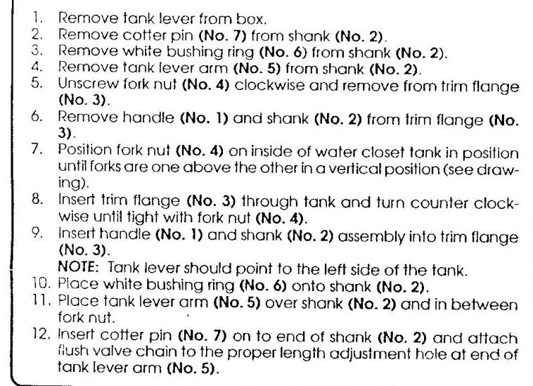

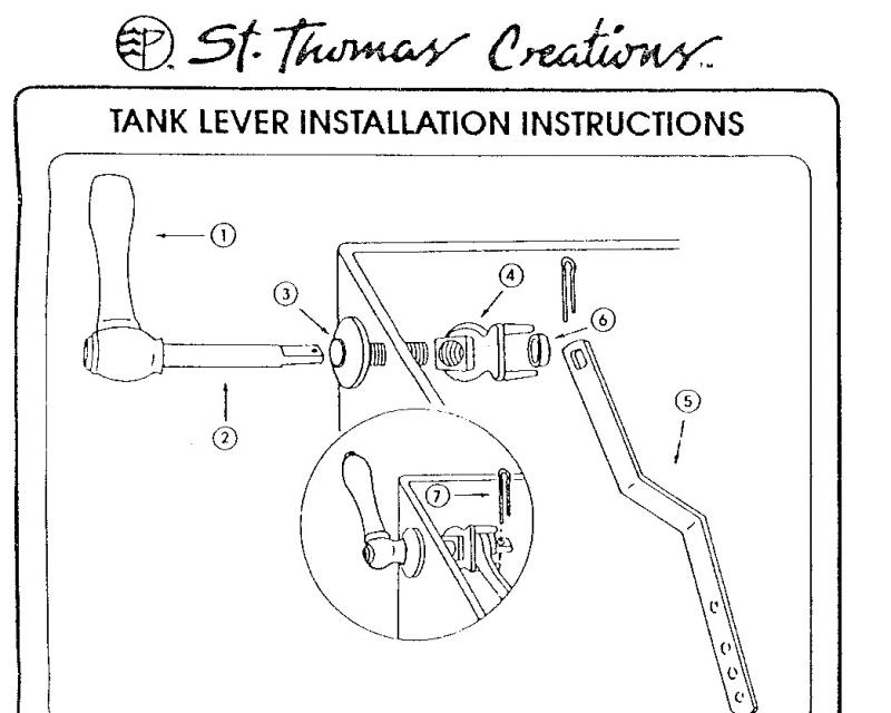

Help! I have a St. Thomas Creations 9400.120.97 Front Tank Lever installed & I need to remove it.
There is a chrome trim flange, a metal ring that goes between the actual lever and the tank,
then the trim flange screws into a piece called a fork nut.
I can't untighten either of these parts & am afraid the tank will crack if I apply to much pressure with channel locks.
Has anyone ever worked with this lever before? I want to try to remove it before calling in a plumber & paying $160
to remove this blasted part!
Advise Please
Lisa
This is the lever I am working with:
This is the diagram & instructions.
The trim flange is part #3 and the fork nut is part #4
