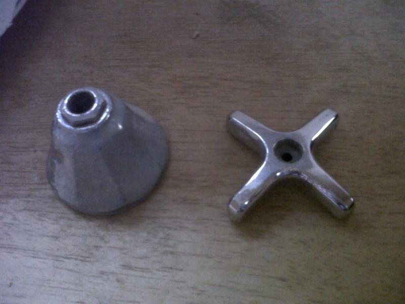

    I've been having trouble with my shower leaking from the stems and the faucet while the shower is on. I wager after some research it was a problem with the diverter. So me and a friend from work where going to redo my shower walls anyway so when i knocked down the wall I notice it was also leaking when the diverter wasn't up either. I proceed to remove the stems with no problem, but the diverter is another issue. I can't seem to remove it, even after removing the packing nut in front of it. I continue to turn it counterclockwise but it just spins forever, the duct tape was purely there so i could tell if i was making any progress in the steam moving outward.
    I inherited the house after my parents passed away a few years ago, but i never got to find out what kind of fixtures these are. I've included pics of the faucet and the stem from the hot and cold valves. Any info on how to remove the diverter stem, and an I.D. on the old steam since no one i've asked has been able to tell me what brand/type they are. Thanks in advance!

    A photo of the handles and trim would help identify, BUT jad is correct.....you obviously have a remodel in progress and the plumbing inspector will NOT allow you to leave a non scald protected valve. And why would you want to?? This is the perfect opportunity to put in a modern valve. Do you want to install a new tile job, hopefully to last 20+ years, leaving a valve which may already be 30 years old.??

    Here is a picture of the trim and handle. I'm honestly not to sure of myself on replacing the valve right now. It was a difficult enough job to just get to this point. I'm extremely ignorant on home repair things such as this and my friend is just as clueless, we got the other walls up and we're going to do a simple tub surround once i fix this leak. At this point I'm honestly just looking to stop this current leak so i can go back to my normal life and actually get a shower.

    Handles could be Sayco or American Standard. Stem looks more like the AmStd. Take it to a good plumbing supply house. The local hardware store is not likely to stock very old stuff like this.
