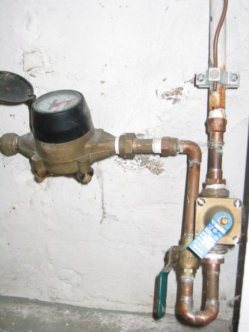

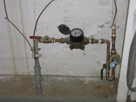

The house was built in the 1920's and a mix of copper and galvanized pipe is running through the house currently. Luckily all of the upstairs fixtures have 1/2" copper running to them. The basement is another story. Basically the current setup is this:
1. Lead Supply Main into house (2" maybe, never really measured)
2. Shutoff
3. 5/8" Water Meter
4. Shutoff
5. Small length of 1/2" copper tubing
6. 3/4" Pressure Reduction Valve
7. Another small length of 1/2" Copper to join to existing galvanized line
8. Then galvanized pipe runs the length of the basement, where it T's off to the hot water heater (where it is again joined to copper, it was recently replaced by previous owners) and the 1/2" copper running to the upstairs fixtures.

The meter is probably about 40-50 ft from the street (city water). I should clarify... the meter is actually in the basement, and I won't be replacing the line to the meter... only from the meter. The line I'd need to replace is about 30 ft long before it starts branching off to the various fixtures.
attached are some pics of the where the service enters the house...

Just use 3/4" and branch off with 1/2" to the fixtures. 3/4" in and out of the water heater.
