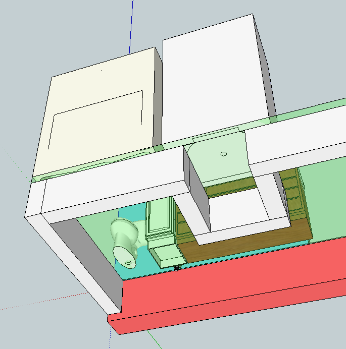

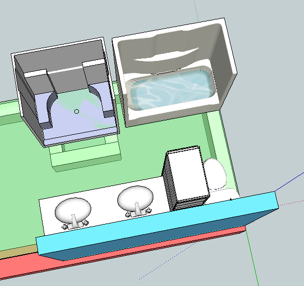

    As I noted in a different thread, a licensed plumber will be plumbing (at least DWV) a bathroom addition for me.
    In the drawing below, there is a soon to be poured concrete slab (in green) and also a soon to be poured foundation (in white).
    In order to maintain access to the second port of the septic tank, there has to be a slight "crawl space". As it happens, the shower drain will also need to run through this area.
    When we pour the foundation, we will need to provide an opening in the foundation for the shower drain to meet up with the tub drain.
    My question is: What is a good distance (vertically) from the bottom of the shower to the port in the foundation?

    Yes he will. But he won't be out there for at least another three weeks and we need to pour the foundation next week. I would try to explain it to him over the phone, but he and I would both be confused before that was over. He isn't exactly high tech or I would just email him a drawing.
    I am thinking about just making a couple of 4" ports. He can use the one he wants and I will plug the other one.

    hj, the septic tank will extend about halfway under the addition. One port of the tank will be easily accessible. The other port will be under the addition about 30" past the outside of the foundation. When the plumber originally looked at it, he said we could either make a U around it or pour straight across it. This was with the understanding that if we placed the foundation across the tank, it would be very expensive were an issue to occur with the buried end of the tank.
    He didn't know (neither did we) at the time that we would want to put a shower on top of it.
    Is it a good solution? No. However it is the only one that will work with the site. There is no other place to add on to the house and moving the tank is really an option at the moment. Access through the foundation to the port will be approximately 24" high and 24" wide.
    Edited to add: The shower drain will be in the way if some needs to get to the tank port. However, PVC is cheap. We will probably seal the 24"x24" access with a 3" concrete panel or something else suitable for ground contact.

    Ironically, we have rearranged the bathroom layout (no tub or shower unit, added a large corner curbed shower). No drain will need to run through the inset area now, so my original question is unneeded.
